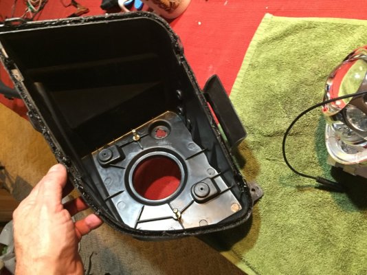

If you're handy with tools and a heat gun you can build a set yourself. Here's a series of pics illustrating how I did mine. I found everything I needed on Feebay. Think I spent probably $200 on parts (stock headlights; projectors; halo's, mounting system, etc) and about 20 hours work. I ended up changing out the bulb type to a DS2 because it needed to fit within the base of the stock reflector. I also added amber turn signals but didn't use them as the turn signals included with the projectors were fine but I can wire them up anytime I want.

WOW You are handy much more than I am I can turn wrenches but I don't think I'm up to all this, way more than I can do. Maybe I'll just go with an LED bulb onversion instead of different headlights.
