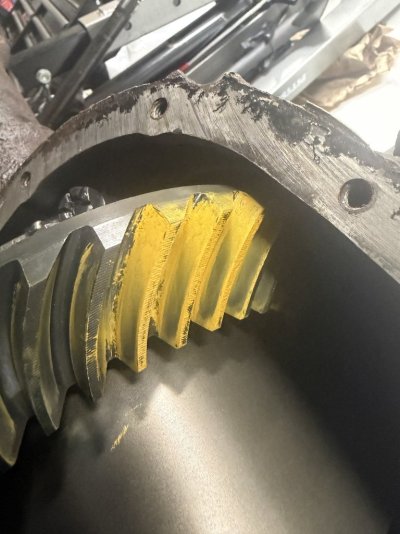

Looking for a second set of eyes from guys who have done gears on S197s (especially 3.55 + Truetrac setups).
The car is my 2009 Mustang GT with New 3.55 Ford Performance gears new Eaton Truetrac New bearings throughout Raytech Solid pinion spacer (no crush sleeve).

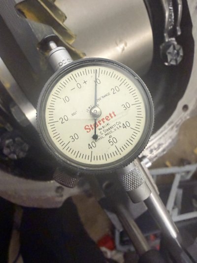

From what I can tell, it looks like a good, usable pattern its just not "perfectly centered" heel-to-toe. I've heard Ford Performance gears can look like this and settle in after break-in.
Setup details:
Pinion preload: ~17–18 in-lb (new bearings and I'm running on the low side for road racing)
Backlash: right at .009 (checked in multiple spots, consistent)
Raytec solid pinion spacer
Pattern:
Slight bias toward the toe on both drive and coast
Centered vertically (not deep in root or running off face)
Good contact length across the tooth
Not sharp or edge-loaded
Main questions:
  1. Would you run this as-is for street + road course /track use?
  2. Does the slight toe bias concern you at all given the backlash is .009?
  3. Anyone running a similar setup (3.55 + Truetrac) seen patterns like this and how did it behave long-term (noise/wear)?
Appreciate any experienced input, I'm at the "button it up or chase it" decision point.

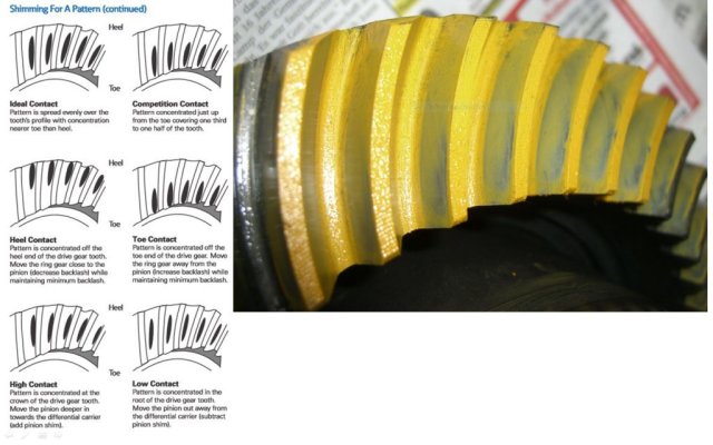

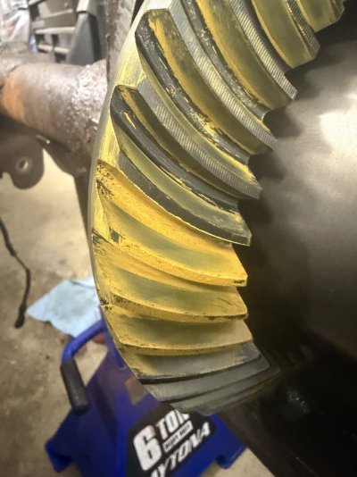

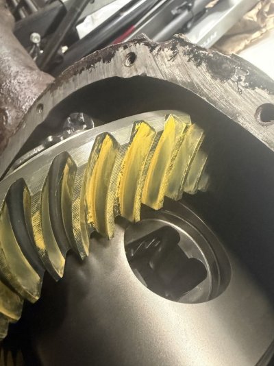

the contact patch is within spec , id send it ,
the second and third pick you can see you have the right amount of center and up down on the gear meshing .. on the lower end you are close but by no means out of spec,
send it

Thanks That’s what I was thinking I’m literally chasing .001 at this point and I think it’s good enough that it will be ok. It’s just been a while since I did a full rebuild so I’m being a little bitch about it.

yea your overthinking it and dont wanna have to rip it all apart again..
you are golden and it wont make noise you are within spec for sure

i aimed for .10 to have a buffer just for that..
and that is a great thing to bring up., same can be said for torq wrenches and pretty much any measuring tool .
tolerance stacking kills engine builds
