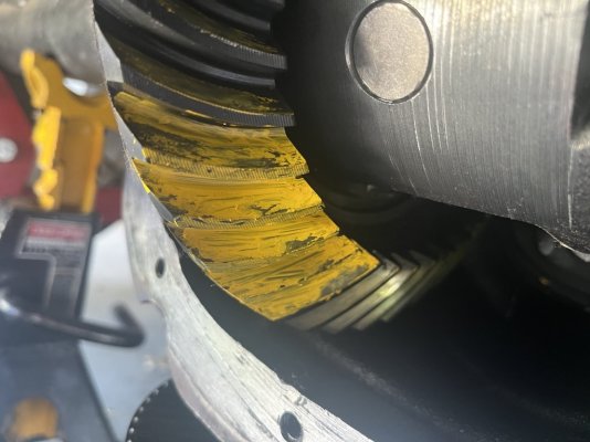

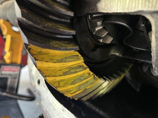

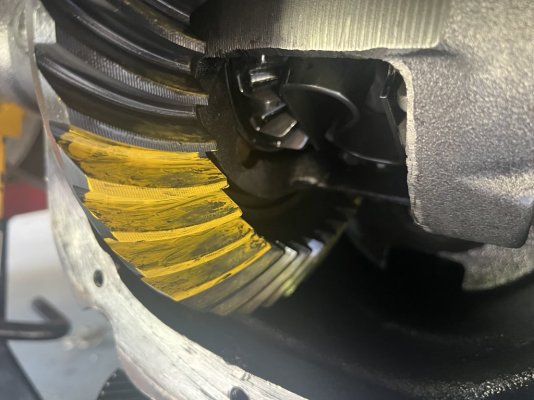

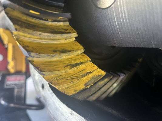

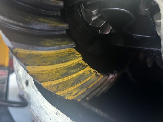

I tried to do another contact pattern before tearing it apart. I loaded the teeth up pretty good (2 coats), let it dry for a few mins, spun the tires several times, and nothing really. Didn’t seem like it made contact at all.This pic has about 20 revolutions on it.
So I thought maybe I wasn’t supposed to let it dry so long. Tried a quicker job and got this.
A little better but I can’t really see anything. Seems easy, apply paint, spin wheels…am I doing something wrong?

I mean, I have no idea but it looks like the pinion gear needs to come back and the ring gear needs to go toward the passenger side…?

Those patterns are not “clean” enough to read clearly. Do not turn the wheels! Hold tension on the carrier with your hand or a bar and turn the pinion. That will show the heaviest contact spot on the tooth. My guess is you need to add a couple thousandths to the shim under the pinion. It looks like the pattern is wiping on the crown of the tooth and is heavy on the toe on the drive side and on the heal on the coast side.
Awesome, that’s it!!! I kept thinking “man there’s something your doing wrong”. I can see how turning from the pinion would change everything!! Love this forum

pinion depth is too low (more pinion spacers.. thicker one) and shims must be added to move the carrier ring
