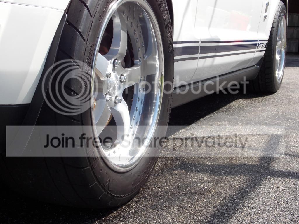

M&H 325/40/18s on my 10" rims works great

Thanks for all the info. Does anyone have a pic of 275s on their 18" stockers?

My car has 255s and they just look skinny, Continental DWS. They just look skinny but I do notice that the sidewall is just about maxed out with the rim. Still trying to find a good side shot pic of these wheels with 275s.
