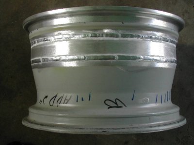

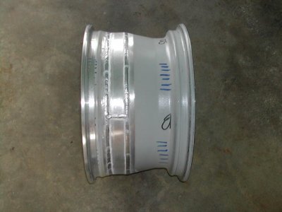

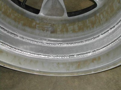

I just had a set of 17" bullitts widened to 10" by Weldcraft. I should have them back later today hopefully if I can catch Fed Ex. I measured everything and the axle snubber pad on the frame rail needs to be modified. You need to move it in an inch and weld in back in place. I just did mine and was not too difficult. I am going to run the M&H 325/45/17 drag radial on the street and either a MT slick or MT 325/50/15 drag radial at the strip. Once I get them on my car I will try to get you a few pictures.
Redfire
Apr 15, 2007
210
I got the wheels back today and they fit good. I don't have the tires yet but hope to Friday. I can tell you if you do widen the wheels to 10 inches you don't have to relocate the sway bar but it should be trimmed a 1/4" to be safe. The axle snubber pad has to be moved in though to get the wheels to fit.

That's awesome! And it's good to know they will fit with only a tiny bit of modification. I'll have to have a shop do the welding... I can't. the 2 stock wheels i ordered are here, so now they are off to weldcraft :)
