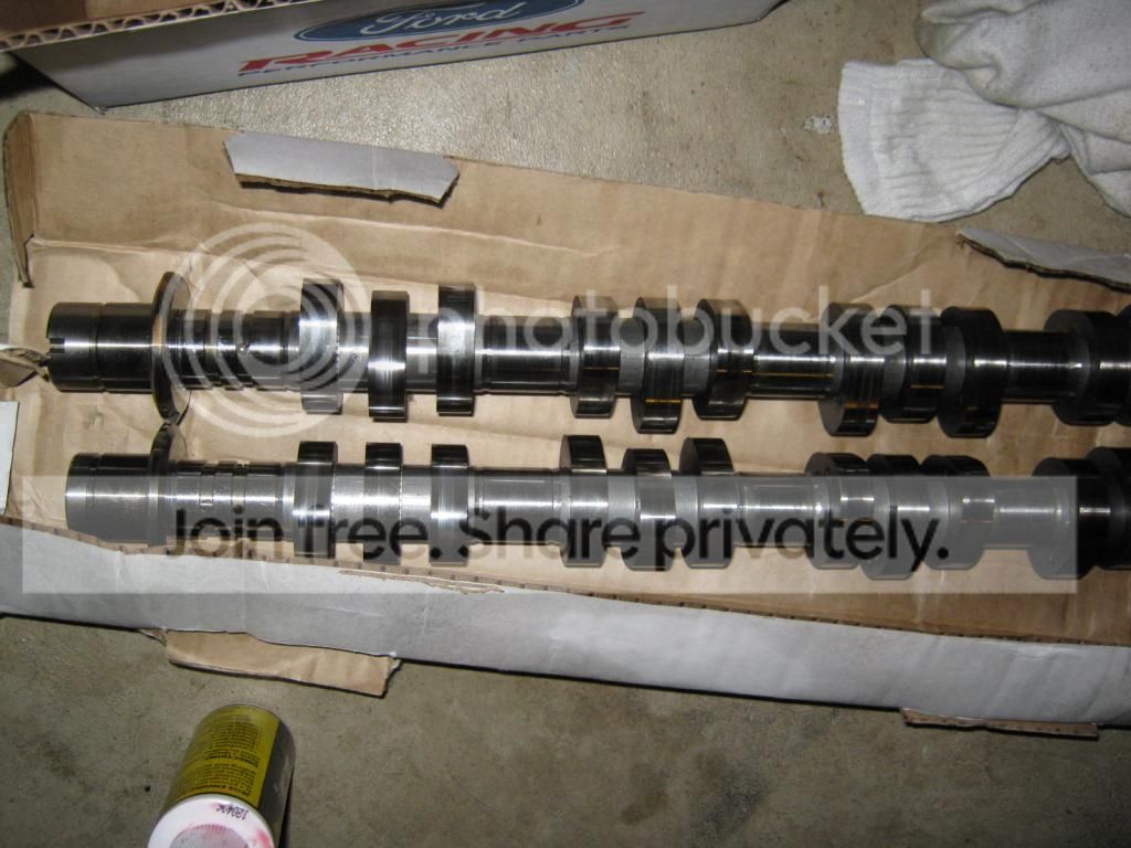

Did a little more tonight. Put the lash adjusters and rockers in tonight along with a set of stock cams.
Gave the rockers an oil bath prior to installation. The lifters had been pumped up with oil previously.
Lubed all of the cams parts up with assembly lube to make sure something will be there whenever it gets it's first start.
Stock cams. Notice that one side has a longer front end than the other. The longer snout goes on the head that's sitting farther back on the motor.
