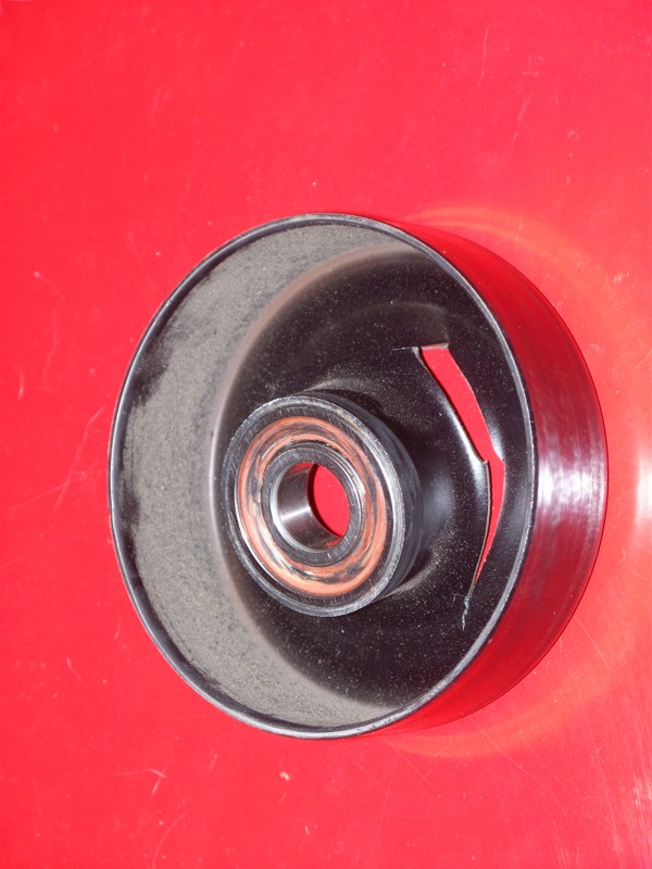

I did have an issue while using a thump tensioner where a stock idler pulley sheared around the bearing. That said, the number of belts I was going through without the tensioner made the tensioner worth it. I just switched to billet wheel idlers with double bearings.
