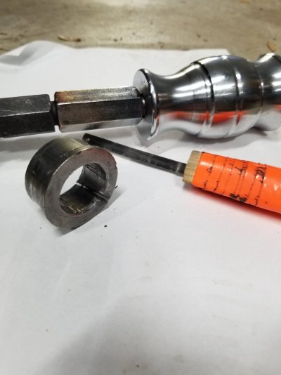

I got the trans out without issue. I think being able to slide the engine forward helped a lot. I just removed the one bolt going through the prothane motor mounts and rocked the motor back and forth using the tail shaft of the transmission. getting the motor mounts lined back up should be fun. I put a plastic cap on my clutch line from a royal purple gear oil bottle. I secured it with some duct tape and was good all day. came back next morning and brake fluid all over the floor. I'm guessing my clutch master cylinder is going to be a bitch to bleed now? the cap had a split in the side, not sure if i did that or the brake fluid did it. The pilot bearing was a real stinker! I made a shiv out of a mini hack saw blade and used a flat blade and 5lb sledge to finish the job. My slide hammer just wasn't going to get it out without help. 1699142965917.jpeg

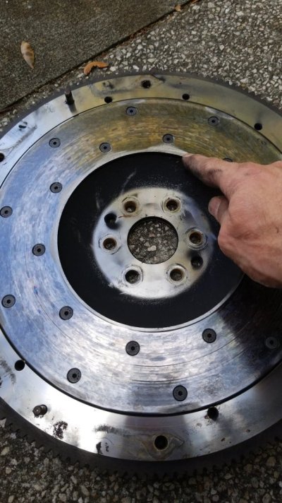

The actual clutch disc looked fine and still had some life left, the pressure plate looked ok, but the friction plate on the flywheel was warped, glazed, groved, it was bad man. If i ever go with a stage 3+ again i'll use the stock flywheel. I'm not sure how much of the actual disc was making contact. 1699144257773.jpeg
