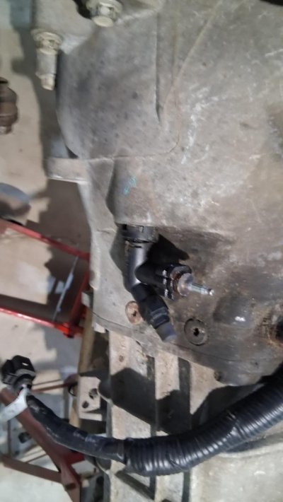

We're working on swapping a TR3650 into a 2007 Mustang and I got a couple questions:
1) How do you get the fitting for the clutch line off? Either the whole assembly or the "nipple" on the end? I got a new clutch line with new fittings and I'd like to replace the old one.

On my 2010 the clutch line simply plug into the plastic fitting on the bellhouse and is retained by a steel wire spring clip. Hook the end of the wire clip and pull it out of the plastic fitting and then the tubing will pull free. Don’t loose the clip. You will need to reuse it. A similar arrangement connects the tubing to the master cylinder.

Thanks. We got the plastic clutch line assembly off and it must have taken on water because it was all rusty. We're going to replace it.
