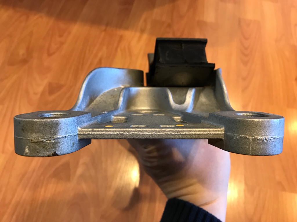

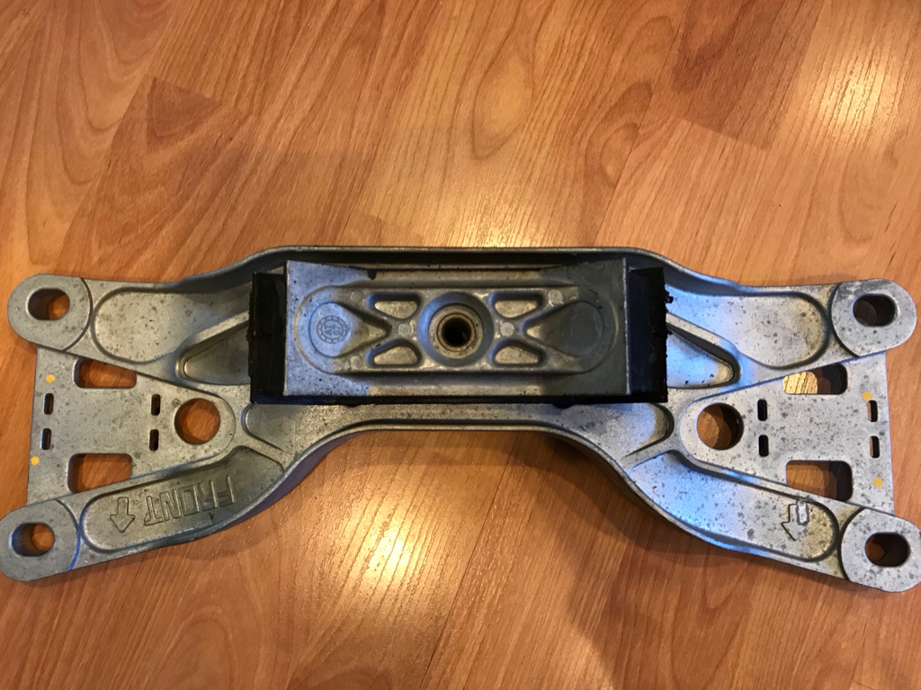

If you have that cross member off of the car we should get pictures of it. It looks like the only difference could be mounting hole position.
That billet thing looks like it's all in a couple planes, would be fairly fast and easy to turn out.
Compared to TR3650

Don't need - he has a 3650 xmember in the photos and I have one too. Can use that! Thank you RD!
You’re welcome. I’ll see if I can do better tomorrow. I’ll check with a friend of mine that does CAD, and see what the best approach is.
