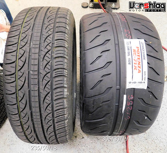

With just a few hundred miles on the odometer and the stock, craptastic 234mm All Season tires I drove to MSR-Cresson for some Baseline laps. Track Test # 1 is shown below. Only change was some Motul RBF600 brake fluid and tweaked tire pressures. #500psi
The stock tires were massively holding back the potential of this car, but the brakes weren't doing the car any favors. We ordered this car as a base model with the 14" 4-piston front brakes. I could overheat the pads in 2 corners, so I took it easy - still murdered the pads and lost brakes after 8 laps. The stock pads were inspected (when replaced with G-LOC R8s) a few days later and they literally fell apart. 100% junk.

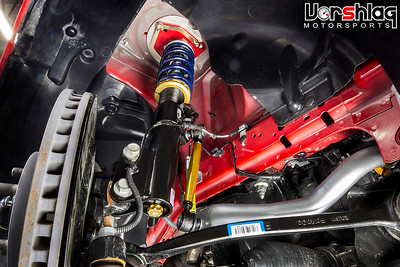

In one day last week our crew installed Whiteline Max-G coilovers, Whiteline swaybars, Vorshlag camber plates and shock mounts, and the 19x11" wheels and 305/30/19 Bridgestones shown above. This is a 200 treadwear tire that is popular in the autocross and track communities. Spring rates on the coilovers were very mild (for us) at 400 #/in front, 550 #/in rear. Camber was set at -3.5° front and -2.0 rear. Very livable daily driver setup. We drove it to the track for Track Test #2, shown below.

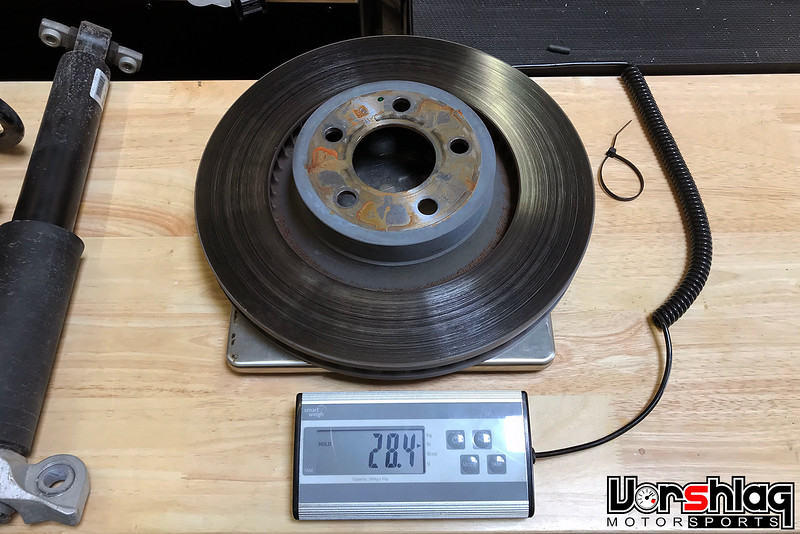

The '15-up Base GT front calipers are 4 piston, but that's where the similarity ends. they are radically different in size, use a completely different pad shape, and the rotors are as different as you can imagine.
I will get into more of a comparison in our actual S550 build thread but the rotors are a huge fail
Notice the backside of the rotor above - its completely sealed off. There is no physical way to add any brake cooling to this rotor.
This is a first... never seen a front rotor with backwards venting. Bizarre. And I can tell you first hand it doesn't work at all. We did 8 laps on brand new stock pads and they failed - came apart. Lost brakes. Even with Motul fluid and G-LOC R8 pads up front I couldn't do two hard stops in a row, inside of a single lap. I had to nurse the heck outta the brakes...

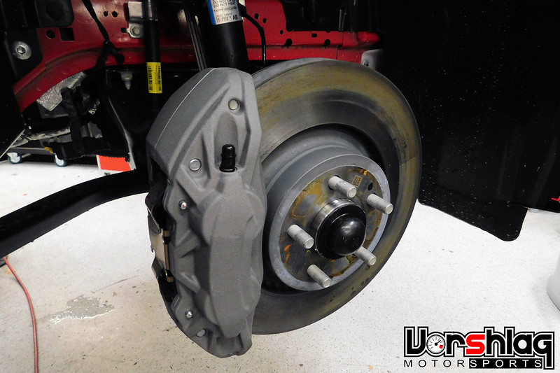

Well I don't know about FAR superior... but the S197 14" Brembos can at least get some brake venting.
That's a big deal. The new 14" 4 piston stuff is just... dumb. The new caliper looks better (below), but without any way to do brake venting, its worthless on track.
Of course the S550 15" PP1 brakes (below) and 15.5" Shelby brakes don't have ass-backwards venting and they can be cooled for proper track use...
