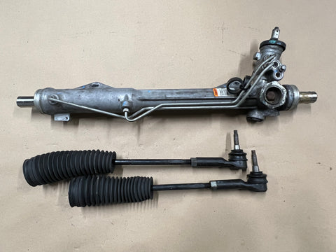

I recently got a really nice 4.6 2009 3v that was fitted with 5.4 internals and a bunch of other stuff. I love the car but the suspension was lacking and I've had a couple alignments to not much success, and I have since replaced the whole tie rod assemblys, the rear upper control arm, and tried to adjust the pinion angle on jacks because no shop near me even knows what that is. I'm going to tackle one problem at a time so I would like to fix the movement of my power steering rack. I get slop in the middle and going over bumps is scary, the car is not safe to drive because of this. I can't seem to find anything about replacing bushings on a s197 and I read somewhere that it bolts straight to the k member. I can't tighten the bolts any more to keep it in place and it still moves. Am I missing anything. Does anyone know what I could do here, please! I want to get this thing back on the road already.
The steering rack mounting bolts go through the eyelets from the top of the rack and screw into the sub frame. If they are over tightened and back out at that point the whole rack can/will shift when turning. No Alignemnt Technician can Align properly with a rack that moves like that. If you look closely at the rack you can see the mounitng tab.
