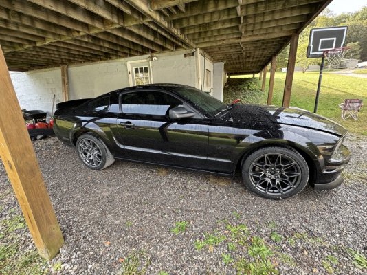

Hello everyone, just bought an ‘06 GT (my first mustang ever!) and I need some help tracking down a replacement for my LED headlight bulb.
In my research, I’ve found all different kinds of bulbs, connections, canbus?, etc and it feels overwhelming.
To pass inspection, I need to put a complete exhaust system on it (just arrived today), and get this headlight working. Other than that, it’s tons of fun to cruise in! I appreciate any help!
