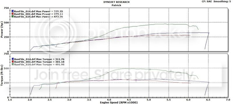

Finally posting up. Finished my turbo install. 67mm journal bearing comp turbo with a .68 ar, On3 hotside, custom cold side, 405 walbro, 47lb frpp injectors, hpx maf, and tuned by Chris Groves at Dyno Edge here in Albuquerque. Thanks to Jeremy for the turbo and fuel pump! Made decent power and pulls strong. Still on the stock short block though.
Red is stock, blue is with the comp mutha thumpr cams, green is the 9psi pull.
