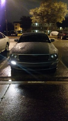

Hey got my passenger side turn signal stuck on, no lights on, all fuzes good, disconnected battery and when reconnected it light came back on.
Anyone know what's going on, and how to correct it???

Car lights work on reverse polarity so a ground will energize them. From the rain looks like something got wet and is grounding the circuit energizing the light. Other than suspect water intrustion at the SJB.

I had the same issue after some rainy days and it ended up being the fuse box behind the passenger kick panel getting soaked, I disconnected the battery and cleaned out all the contacts with electric clean and then let dry overnight and I got lucky everything went back to normal the following morning good luck.
