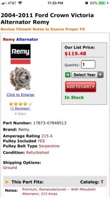

    Figure I may as well upgrade the alternator while I’m upgrading the sound system n stuff. I’ve read a few things about putting in one from a Crown Vic...? What years fit my 2006 if so? Any other suggestions?

    Heard some people have switched to this setup. Something about having to switch out an isolator and a ceramic washer though..?

    4. The Crown Vic alternator. I tried this route but, like the DOB alternator, it would not work with my Kenne Bell. They are cheap and high output. I don't know if they are 6G. You will need a ceramic spacer/isolator for the power wire, as the configuration on the back of the alternator is a little different than those made for Mustangs. There is a thread on this forum about the install.

    The crown vic alt is a 6g but the 05+ p71 alternators are what you want. Theyre I think 200 amp and are made by mitsubishi. Also I believe they have a clutched pulley. Only p71’s had them though so be mindful of that if youre looking for one. Ive heard good things about the 10 gt alt made by Denso too.
    If I had to buy a new alternator Id buy one of those two and skip rebuilt/remanufactured or aftermarket alternators.
