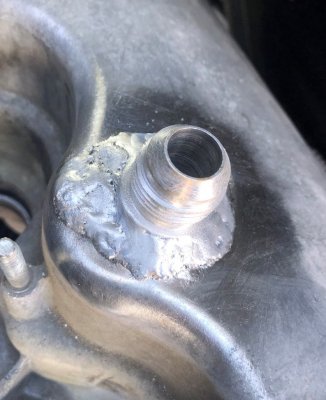

With the new engine in I wanted to add a catch can. I was told that I would not want to use the typical pcv breathers so all of that was removed. I knew going in that the material of the covers was just a shit cast of whatever Ford had laying around at the time. I had two local reputable shops attempt to weld the holes closed after removing the vct all together. They also welded two -10an bungs I've had these shops weld things in the past for me and have come out perfect.
These looked like hell when I got them back but after how long it took this build to complete and with as many obstacles I encountered along the way, I wanted to get the thing running so I slapped them on last spring. They were fine for the majority of the season. Only put about 700 miles on it altogether and I noticed the weld on the driver's side vct hole was starting to leak.
I don't really want to use these covers anymore, and I have another unmolested set at home I'd like to try to use. I need the -10an bungs welded on, and the pcv/vct holes closed.
Short of buying the $700 Moroso covers that have the holes pre-closed, does anybody have any ideas of where I can send my clean set out to have the same thing done?

Those welds are full of gas bubbles. Find a shop that knows how to weld. Looks like they used a wire gun also.
I would have used a Tig.
For the AN10 fitting a Bulkhead fitting with “O” Ring or Rite-Stuff sealant may do the job.

Believe it or not, these shops produce great quality work but both said they had zero luck attempting to weld anything on my covers. You're suggesting a bulkhead type fitting fabricated where the pcv port is?

If you are not familiar, among AN fittings a bulkhead fitting is similar to a tube union with the addition of more threaded on one end to allow for a nut to secure it through a wall. Another option is a AN to Boss adapter. It looks like a male adapter but the threads match the AN thread form and have no taper. A nut and “O”Ring is used to seal. I think the Boss Adapter would be the best option if welding is not possible.

FWIW, the cast aluminum material the valve covers are made of is nearly impossible to weld (I think the oil impregnated back side corrupts the weld as soon as it starts to get good penetration). I'm surprised they got is as good as they did.

I remember squidd having problems welding with these and I believe the magnesium content is the big issue.
I tried to sand mine smooth before painting but it seemed like dirt or sand was getting plucked out of them with the sander.
I gave up, used a zinc etching primer, then a surfacing primer before painting them. I decided at that time to abandon the thought of welding bungs onto the mystery metal and decided to use breathers.
