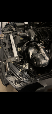

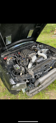

Hey guys, so for any pro-charger owners (not sure about paxton, etc) be aware of the piping issue that i faced recently. Maybe its a self explanatory, but still i decided to post about it, here is the issue. The intercooler piping in their kits is made of steel, not stainless and painted on top with some questionable quality paint and no rust protection. If your kit is older then 3 years ish, check the piping for rust, because it is a huge issue from no under-tray in our cars and heat exposure. I caught mine in time, got it sand blasted and powdercoated and it was a close call since the rust under paint in some places was really bad and hidden on top with the paint. Make sure you inspect your piping, because if it rusts through and will suck that crap into your intake - you know what will happen. Procharger new piping is impossible to get, and costs around 1k for couple pipes, so get it redone.

Unfortunately no close by's, but here is what i have, the first image is you can see paint starts bubbling,
and you will think not a big deal, so on the second pic you can see bubbles on the bottom pipe if you zoom in, when i started sanding down the pipes - it was way worse then i expected, 60-70 percent of each pipe was covered with rust. Third image is after sandblasting and powdercoating and polishing the head

I called, them - they said its due to age of the kit bla bla bla, tons of people have the same issue , they just decided to make pipes out of material that rusts. No close ups because i decided to warn people after the i actually fixed the issue, found the pics that i had left, you are not really inclined to take many pics of the engine bay that looked like that :)
