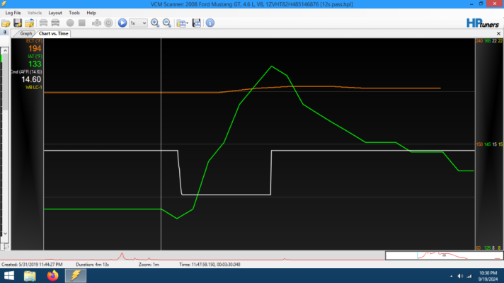

I believe when the bypass valve is open air is allowed to inter the plenum without passing through the heat exchanger. I dug through some old data logs and found one that shows exactly what I mean. It is not extreme but does show the boost and temperature swing.
First is the IAT taken at runner #6 of the intake manifold just before interning the cylinder head.
The second screen shot is boost pressure hi-lighted in the exact same place on the chart.

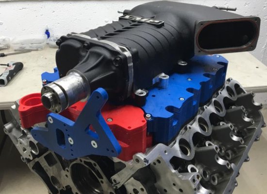

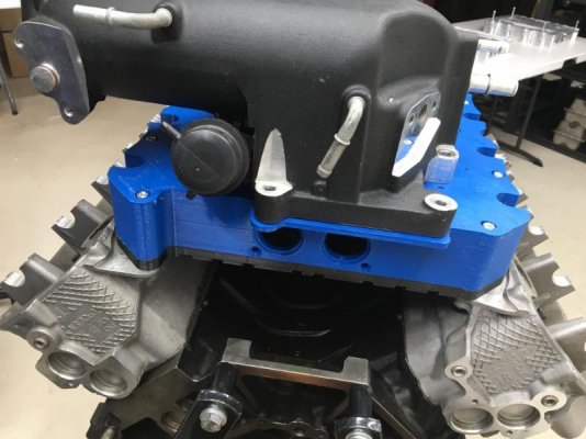

Another issue you're fighting is heat soak. The supercharger intake/IC manifold is aluminum and bolts to an aluminum head. This results in higher temps within the intake/IC as the engine gets up to operating temps. DOBs answer to that was adding about 1/2" of high temp insulation material between the supercharger manifold and head (and one of the reasons I bought it). I imagine it's good for at least 20 - 60 deg or more. In my case my IATs never really go higher than about 120 (compressed side/summer 85 deg/freeway speeds) when I'm not on it and up to 128 - 130 when I am. The highest I've ever seen was 150 but the pump wasn't working right. My temps can go up over 130 - 135 sitting in traffic but that's about it unless there's something not working right in the system. In winter (50 - 60 ambient) I may not see higher than 85-90 compressed on a given day. The other things I added that probably help contribute some are a 170 deg thermostat and a De-gas jug by-pass that improves flow somewhat. I haven't tried adding larger lines yet but if I did I would probably go with 1" primary lines and a bigger (higher flow) pump.
Here's a pic. The insulation material is at the bottom of the manifold (easier to see on the mockups).
