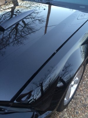

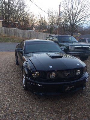

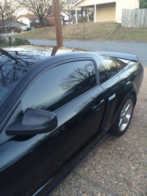

So yesterday we finally had a nice day. I buffed and polished my car, and applied a sealant. I have been using chemical guys 5.5 hex logic pads with a porter cable 7424 xp. Well I use orange for buffing, white for polishing, black for sealants and waxes. I had two orange pads fall apart on me. One just flying off the velco back. Has anyone had these problems? If so do you have a pad recommendation?
Thanks
Also glory shots of the car :)
