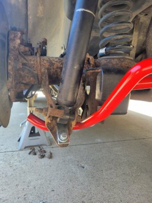

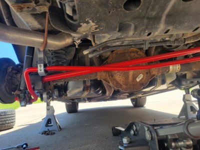

I got a Nolathane sway bar. Seems to be high quality components but I'm wondering if I installed it upside down. The directions don't call for one way or a other so I'm a little confused. Here's some pictures I took.20220617_122037.jpg 20220617_121745.jpg 20220617_121737.jpg

I think it is up side down, compared to my stock bar. The end should point to the road.
I ended up calling Nolathane and they said it's on there correctly. Thank goodness, it takes more time jacking the car up than actually taking the bar off and putting it on
