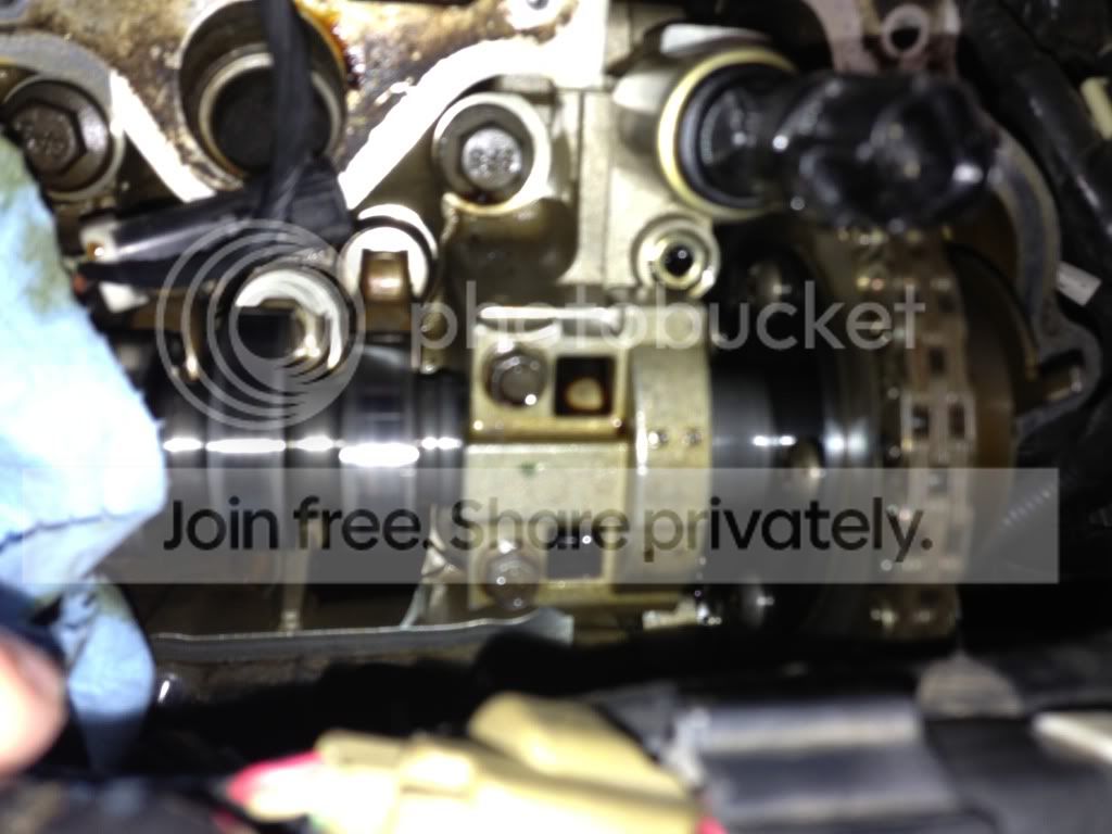

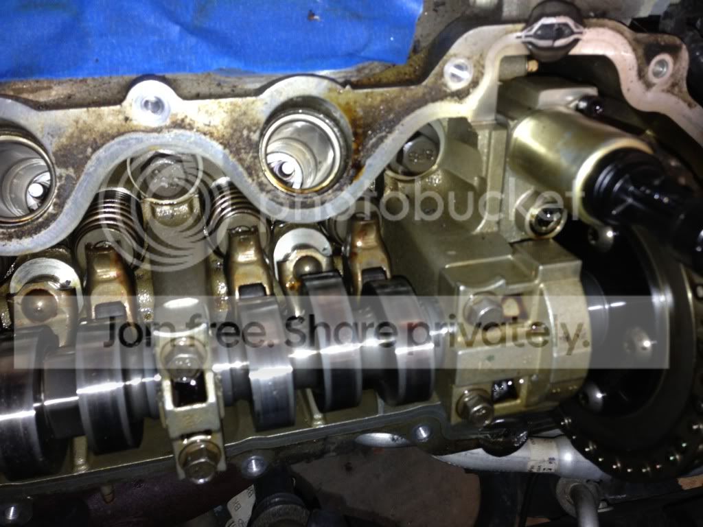

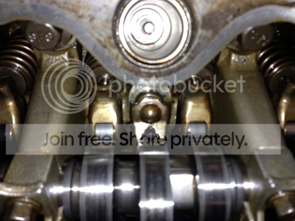

I took covers off and didn't visually notice anything. Anything I should look for or keep an eye out for? I'll take pictures in the morning.

Bigchris. Phaser looks fine, from what I can see. And I unplugged the VCT and the noise continued
