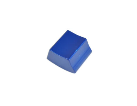

I built the same engine, sort of. I used the flat top Diamond 9.8:1 pistons not the dished and Boss rods. Ran 127400 and 127500 cams in engine along with Livernois limiters. During one cam swap I replaced phasers and discovered Livernois limiter springs were missing/disinigrated. Switched to the Comps after that. No ptv contact, the 2 blue aluminumn limiter blocks still inside phaser prevents that, but the cam advance/retard couldnt have been functioning properly i would think. I'd stay away from the Livernois limiters,

i used these in my loc outs for my mutha thumpers,, dont be foolish and over pay,
i got a kit off amazon that had the hold down wege tool and cam loc tool ,ect for like $70
do not use the phaser limiters,,that allow it to move like 10deg ,they are known to fail!!!!,
