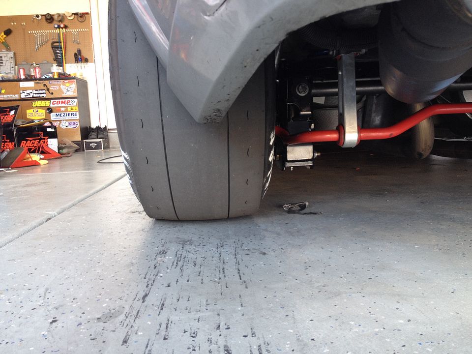

Here's my 18x10 F (285/40/18) and 18x11 R (315/40/18).

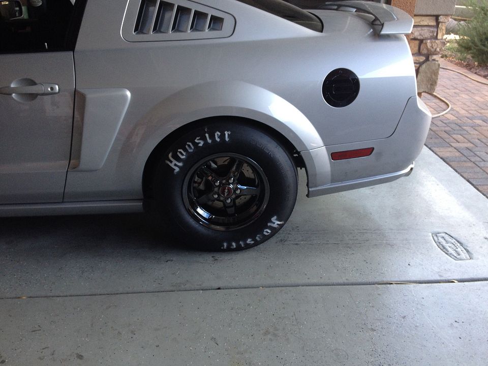

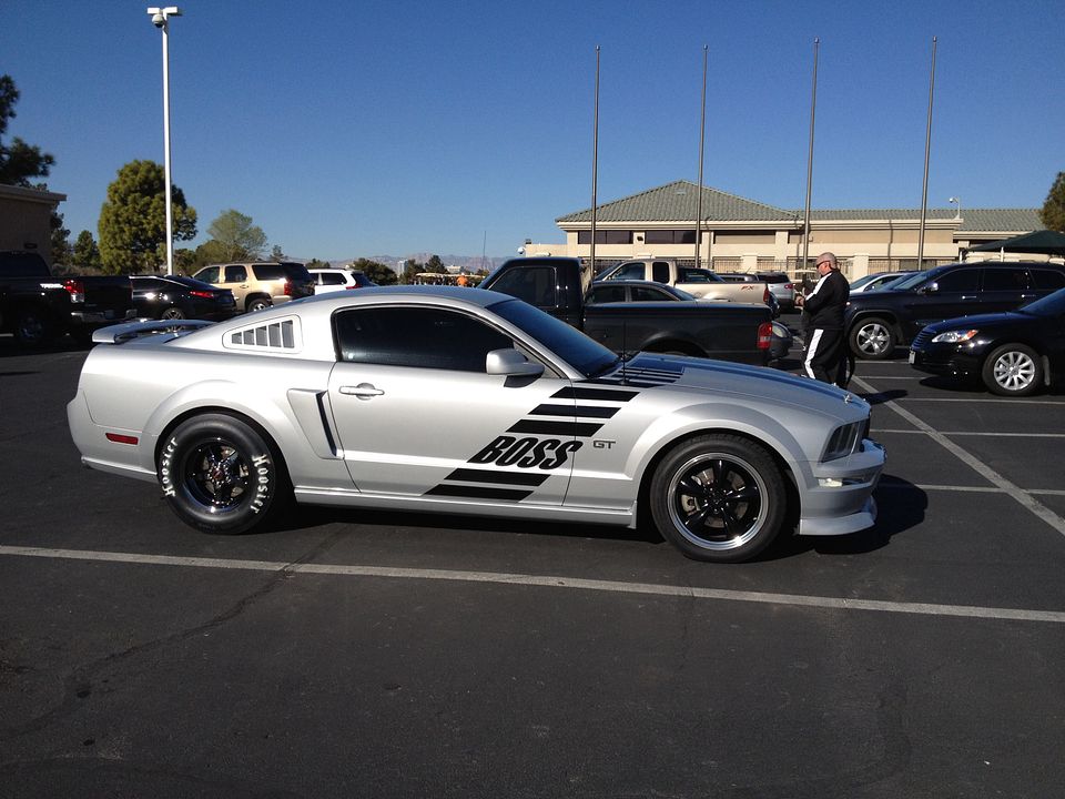

15" x 10" is the way to go if we want max traction.
But for the street I use a staggered 18" set up. 20"s for me are too harsh of a ride. You also lose a lot of sidewall height which can hamper traction from a standing start.
