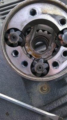

I'm on my 2nd Truetrac, I beat on the first one for 2+years and probably 200 hard launches on slicks. It was still going strong.
The reason I replaced it was when I went to swap gears, I found the case had been hammered into the C clip from the force of the gears slamming into the case, the clip was not coming out,
I had to use a dremel to grind the ridge off around the c clip channel so it would come out.
The one I'm running now has the same issue.
I thought about machining the case/gear and having a hardened steel washer installed but I'm not tracking the car as much .. I'll replace it at some point.
