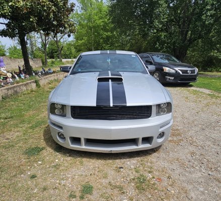

hey all new here. I hope this is posted in the right spot. I have a question regarding my 06 mustang gt roash stage 2. I'm torn between getting struts or coilovers. I've heard coilovers are a harsher ride but great for corning? I was looking st tue roash stage 2 suspension kit but honestly the quality don't look the part. My next option woukd be the steeda coilover kits with sway bars and a few other things. Which would be better probably? Also would i jeed camber plates it seems non of th3 kits come with those? The car has already been lowered and has lots of great mods, i plan on taking this car to the next level. Thanks for any advice, Greg

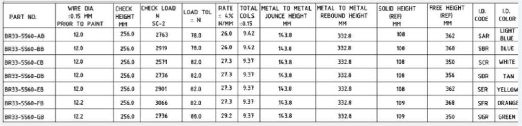

These color codes on the OEM springs address the car weight and the front/rear weight distribution with the different variants, with coil overs you can do it left/right too.

He's talking about using scales on all 4 corners and adjusting the ride height so each corner has the same load/force applied to the road. It balances the car out.
