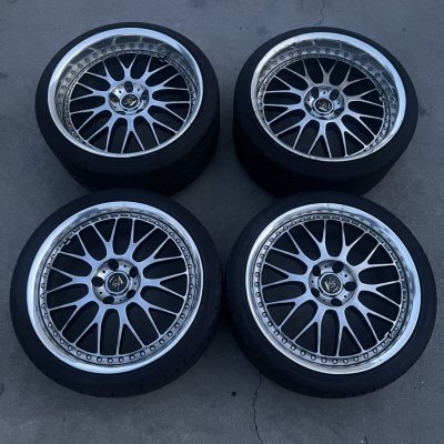

5x114.3 19x8.5 +42 1.5 inch lips 19x11 +46 3.5 inch lips . Front tires 2453519 rear tires 30535r19 . the wheels are 3 pcs work vsxx. please help Thank you

Yes they will, as long as the hub bore is at least 70.6 mm. Most of the JDM wheels in 5x114.3 pattern have a 73.0ish bore unless made for a very specific application.
That’s a big stagger though for front and rear size difference. Front tires are way short too. Maybe look at 255/40R19 which will fit 8.5” wheels and be the proper height. Other caveat is whether or not your car is lowered. If it is, you may get close to the rear fender lips .. 11” rear wheels made for S197/S550/S650 are usually in the +50 to +56mm range so these will be further to the outside by about 1/4” each side.
