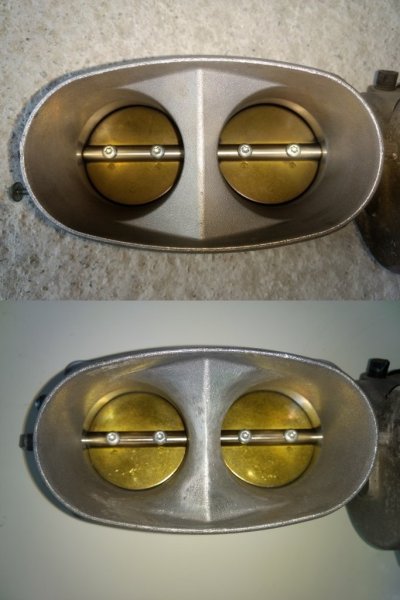

DIY ported throttle body

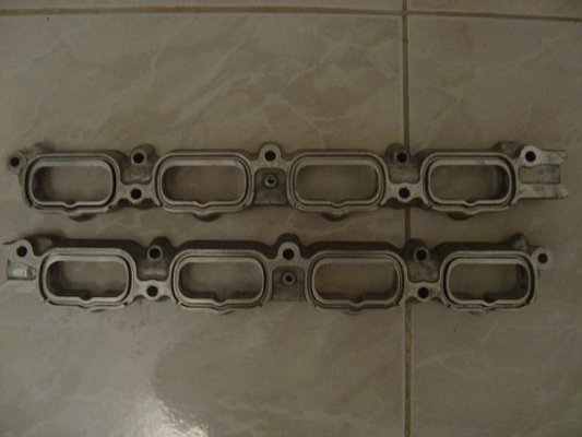

DIY charge motion delete plates (tune required)

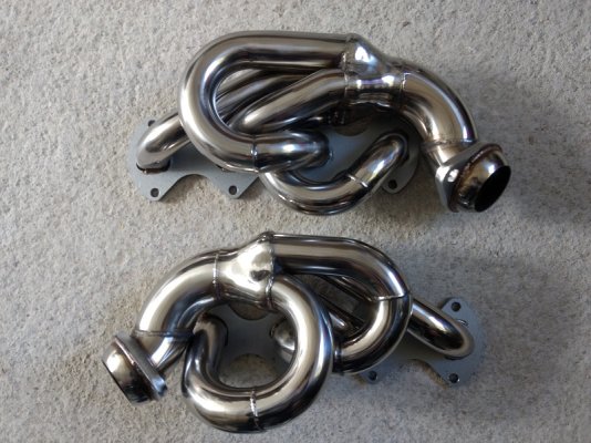

eBay JBA replica shorty headers (they are worth it if you self install)

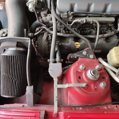

A driver's side oil catch can is definitely a good idea and there's no need to buy a $100+ version. A $25-50 eBay unit like the one I have works perfectly.

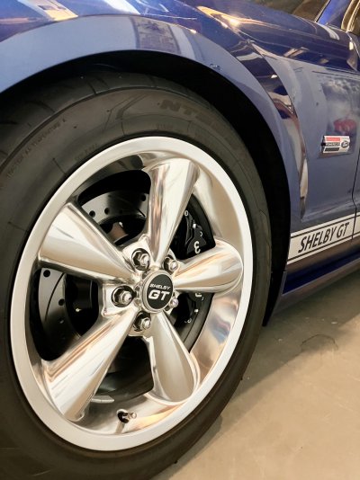

Thanks all, & I’m trying to confirm if Wilwood’s 14” superlight 6R front big brake kit will clear the inside faces of my stock 18x8.5 wheels. Front rotors have .25” spacers which may just give it enough room.
The AM folks think they’ll fit;
Per Baer’s cut-out diagram inserted in my wheel hub, the Baer Pro 14” caliper (w Eradispeed 2-pc. rotor) will just barely touch, so I had to rule them out.
I like the GT’s stock rims a lot & don’t intend to buy different ones, nor do i want to switch for longer wheel studs.

Looks like Red06GT confirmed this in post 11 & 13, so I’ll try a Wilwood 140-9110 kit & post pics afterwards.

My factory bullit wheels did not clear the Shelby branded wilwood brakes, which I believe is the same as what you're looking at. Sometimes they fit, sometimes they don't.

Thanks MrBhp..yes, it’s still not certain, but if it’s Shelby-Wilwood calipers they look to be Wilwood Aero 6’s & won’t fit stock 18x8.5” bullits.
Red06GT was referring to the Narrow Light 140-9110 (or -9109) which both fit according to AM & Wilwood. Fingers crossed & I’ll post results & pics in Tech.

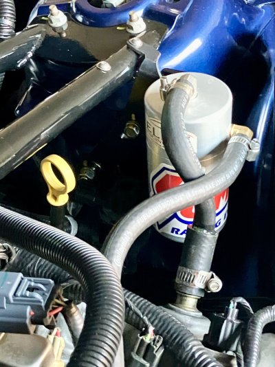

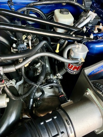

I’m updating this build thread with a few things I’ve added & to also help me remember what I’ve done to the car..first thing was to prevent all that crankase oil going into the intake manifold.
Elite Engineering catch can, mount arm fastened through a hole that’s in the upper strut housing, these are well designed catch cans.

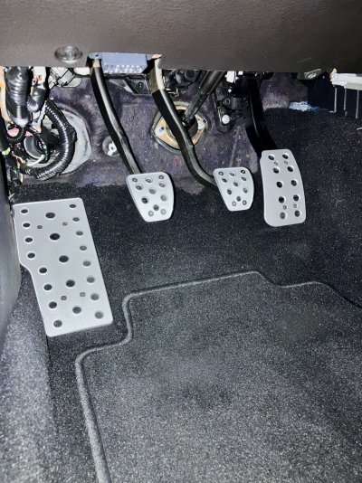

SRP pedals, these we’re pretty simple to install and well made, perfect spacing & made a big difference for blipping throttle on heel-toe (ankle roll) down shifts.

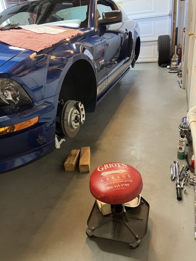

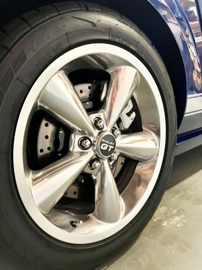

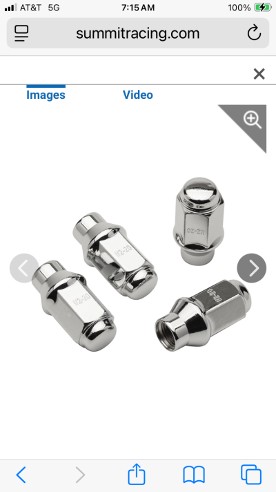

Added Cragar deep flange lugs that extend into the wheel lug holes, these offset the 1/4” rear & 1/8” front concentric Maximum Motorsports spacers I added to clear the Wilwoods.

Added Wilwood Superlight 6 piston front calipers & 13.1” 2-pc. rotors, & 12.9” rear 2-pc. rotors with a Wilwood rear caliper mount bracket, stainless brake lines, Motul RBF600. I’d prefer slotted only rotors, but I confirmed these fit inside the stock 18 x 8.5” wheels & I can feel the loss of rotational weight in acceleration.

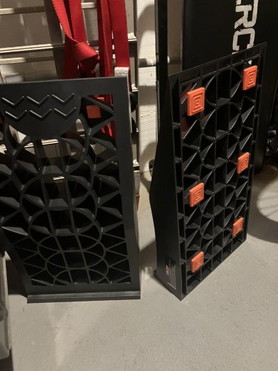

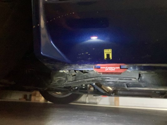

ZR-1 Addons jacking pads make locating the floor jack pad much easier & quicker, & these 3” high Tow King drive on ramps give the floor jack enough room get under the rear diff & front crossmember.
