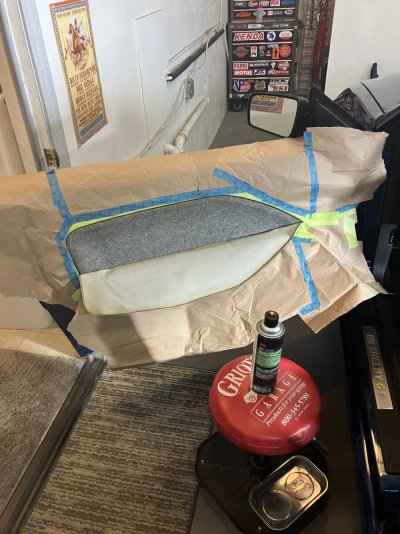

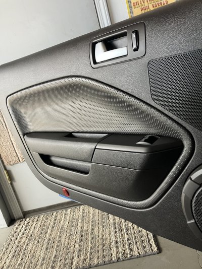

Driver side door panel was sagging a bit & a thorough wipe down, clean up & vacuum off of the old glue substrate allowed the 3M to do its job…will update effectiveness of this project in a year.

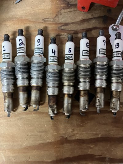

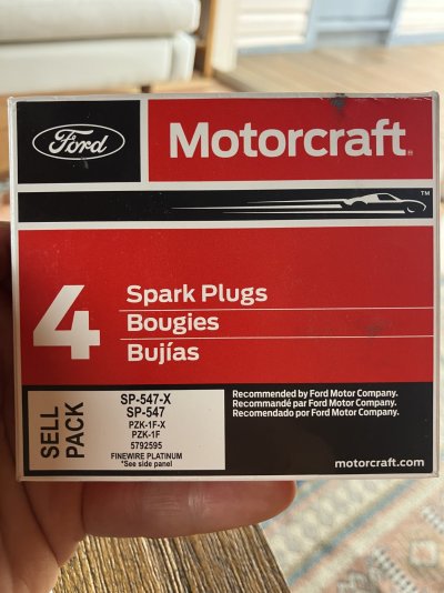

Service so far has been 3.2 qts Pennsoil Synchromesh in the TR3650..shifts so nice, 6 qts Mobil1 5w-30 High Mileage (extra zinc & phos) motor oil & a Goldplug magnetic drain plug, new Motocraft SP547X sparkplugs.

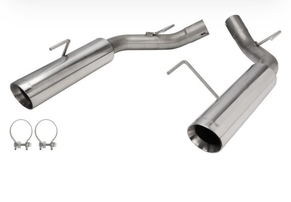

Favorite mod by far are the Pypes pipe bomb axle backs with 4” resonator tips..zero drone, solid rumble at idle, nascar loud 3v bellow at wot.
