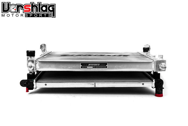

We upgraded to a Mishimoto aluminum unit at the same time as we updated the front aero. Why? Because it was so cheap and we wanted to test it out. Of course we have reverse ducted the hood, which also works wonders. But the engine cooling is now rock-freakin-solid. Still no oil cooler, either.
The stock GT radiator with plastic end caps is on the bottom. The ~$250 Mishimoto radiator is on top
Ford Racing and others make beautiful radiators, but most of those cost double what the Mishimoto S197 unit does (or more - some are $700+). Sure, one or two of them have an internal coolant-to-oil cooler stuffed inside one of the end tanks, but again - not a big fan of that type of "oil cooler". Nothing beats a dedicated, external air-to-oil cooler for effectiveness on track.
