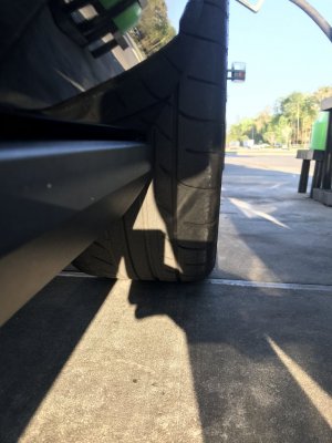

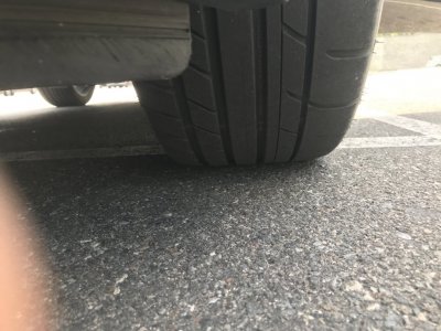

So, the mustang came with 20” American muscle wheels and 305/35/r20 Mickey Thompson street comp 6228 tires in the back and 255/35/r20 in the front. I bought the car about 1k miles ago and I’m just watching the rear tires get ate away every time I drive. They visibly loose tread depth it seems like every time I drive lol. The insides wearing out way faster then the outside (I’m assuming needs an alignment). And these tires break traction through third gear.
