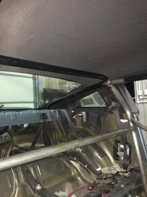

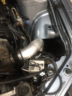

Dropped the car off Saturday for cage. 8.50 cert chromoly. Also having a few additional roof bars and gussets installed for future upgrade.
Also a couple more big changes. I ditched the a/w setup and going back to air/air. Mainly due to class rules and to simplify the car a bit. Still drive it mostly on the street. Ice was a pain. Plus true street wouldn't allow me to refill my ice between rounds.
Should have the car done and back in a couple weeks.

Exciting stuff. I liked your A/W setup a lot......will they let you spray water/meth onto the outside of the frontmount intercooler?

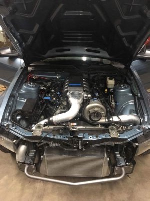

I believe water/meth is not allowed either. I've ran it before. It was effective for iat reduction. I picked up the new treadstone air/air cooler. I'll see how that's going to work. Should work well.

Interesting, I never thought about having to constantly add ice to the IC, even if you're just going for a cruise on the street. It will be interesting to see the difference in IAT between the two systems. Good luck on the 8.50 cage, did you order a kit or are you having it all custom made?
NoviBlownGT
Boosted Crew
Jan 9, 2010
493
11
Marion, IN
I didn't run a heat exchanger.
Im having one built. Adding a few extra bars for future 25.3 cage.

New update!
Back to air/air and 8.50 cert cage install. Hopefully get everything buttoned up this week and head back to the track.
