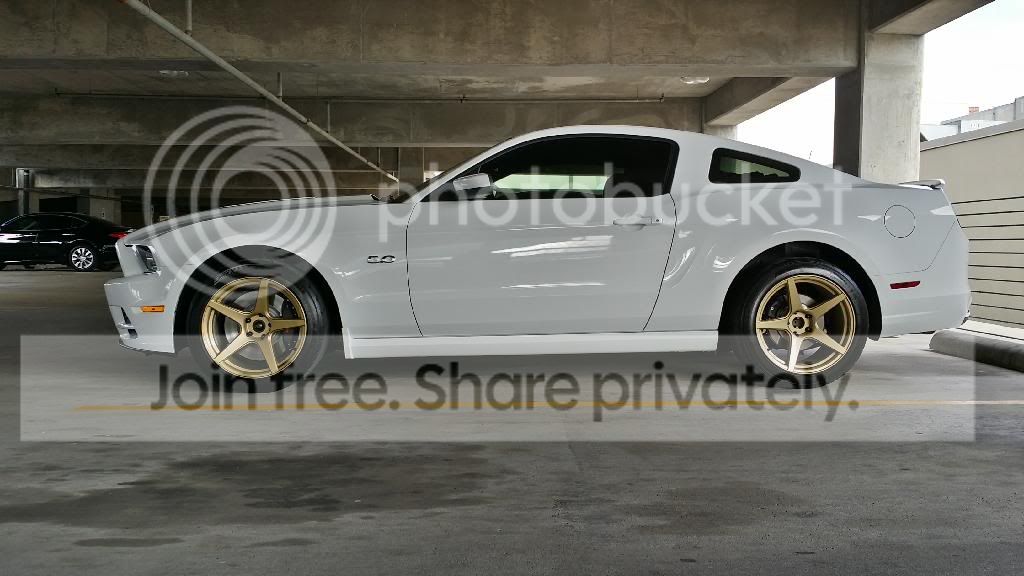

First off, my car is not a daily. I want to buy the best i can get for around $1,500. I've talked to several differant people and everyone shoots what the other person said down. I will be doing lots of autocross stuff this year with a few sessions at ECR. I first talked to Mike White at Whiteside Customs and he recommended BC Coilovers and said they had a lot of success with them on Scott Nussers 2013 sema car. After reading some of Sam Strano's reviews, and after talking to Jason at Hypermotive, I decided i wanted some Koni Yellows. So then i talked Vorshlag and they talked as if the Koni's were garbage and the only non-coilover setup they would use is the Bilsteins set up they have(http://www.vorshlag.com/product_info.php?cPath=141_142_179&products_id=559)
of course everyone else i talk to says I need Koni yellows.
I just want to handle and not bounce around like a pogo stick. as for springs, I'd probably go with sportlines or h&r supersports. I love the flat low look of a car and i don't want too much wheel gap when i put 295/35/18 rivals on.
This is for my 2014 5.0 Brembo M6.
