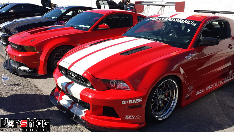

    Lots of good data presented by the OP. Let me take a crack at what he is doing vs what we did in a similar car in this class... edit: to the OP, the 3 second drop going to 315s is a HUGE improvement, btw! :)
    [​IMG]

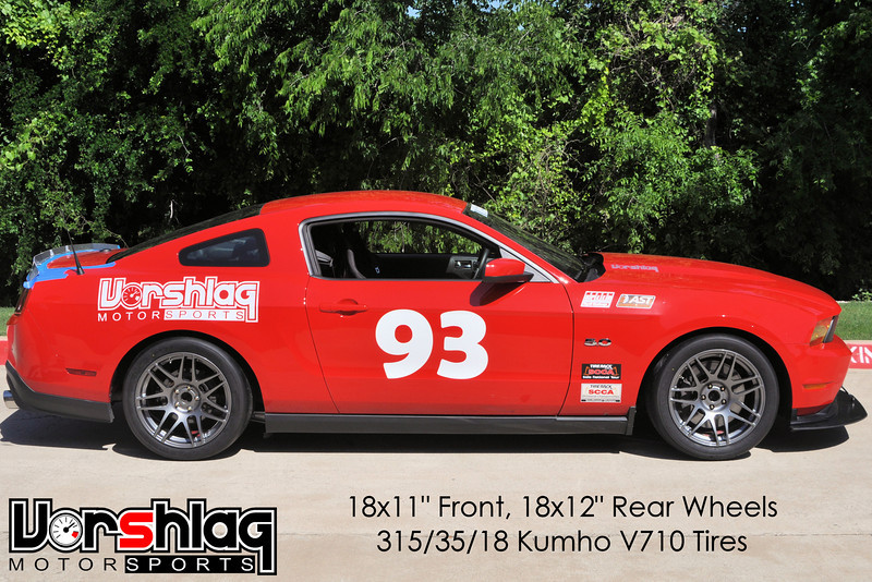

    We came up with the much copied 18x11 front and rear (plus a unique 18x12" rear wheel) package to fit the S197 back in late 2011. No giant spacers needed. If your suspension is setup halfway right you shouldn't need to rotate tires, but I don't know what the OP is using there. A picture of two might help.
    [​IMG]
    The 18x12" rear is a fairly painless bolt on, as it doesn't require fender cutting of any sort. Just need to remove the chassis-side bump stop bracket (about 8 spot welds). But some people don't want to mess with that work, so we just tell them to use 18x11" rear wheels for this tire. My 2011 GT above is on 18x12's and 315/30/18 A6 tires.

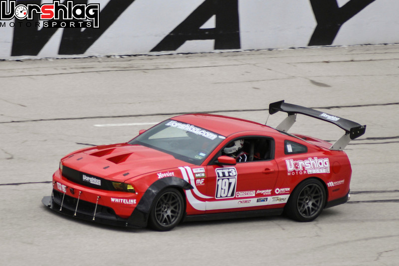

    We ran the majority of 2014-15 seasons with flared rear fenders, then stepped up to 335/30/18 front and 345/35/18 rear A7s. We saw an average drop of 2-3 seconds per track in lap times going with the big tires. We ran at 3802 lbs for maximum p-to-w ratio bonus in TT3, and in some seasons we ran 8.8 lbs per whp.
    [​IMG]

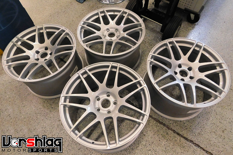

    Forgestar came out with an 18x13" wheel in 2015, and we love this thing. It is what we should have been running with that 345/35/18 rear tire, but it just wasn't available from them at the time. The price is attractive and the weight makes sense for how wide it is. You might wait a while for the "group buy" wheel company to get this one in production, ;) but these can be had relatively quickly from Forgestar.

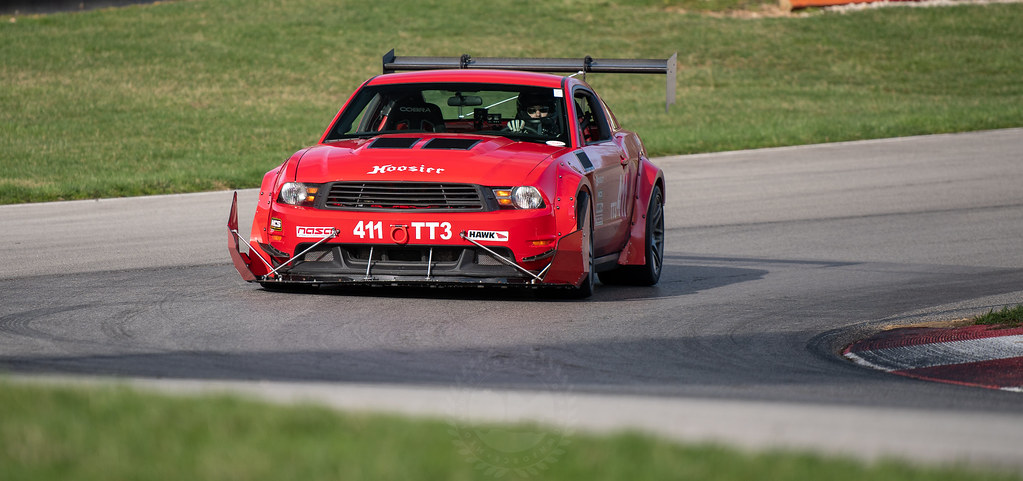

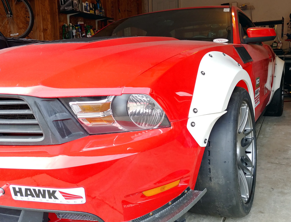

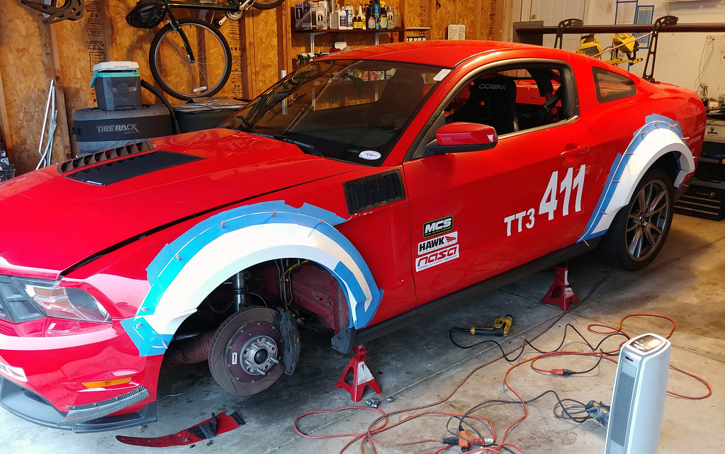

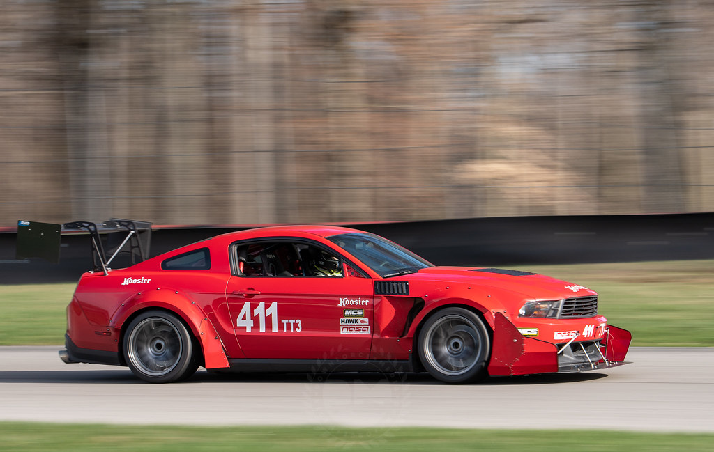

    I don't have a lot of pictures, but these are from about two months ago, and they're near the apex of a low-speed turn:
    [​IMG]
    [​IMG]
    This is one is toward the exit of a high-speed turn a little later in the track, where I'm definitely 100% throttle:
    [​IMG]
    Like I said... I have a pretty aggressive front splitter. I got rid of the canards at the top of the end plates because I found they didn't add enough downforce to overcome the drag penalty, but otherwise it's the same. Even with swan-neck mounts, I'm running the massive 72"x14" AJ Hartman wing at 9-10 deg to keep the car balanced.

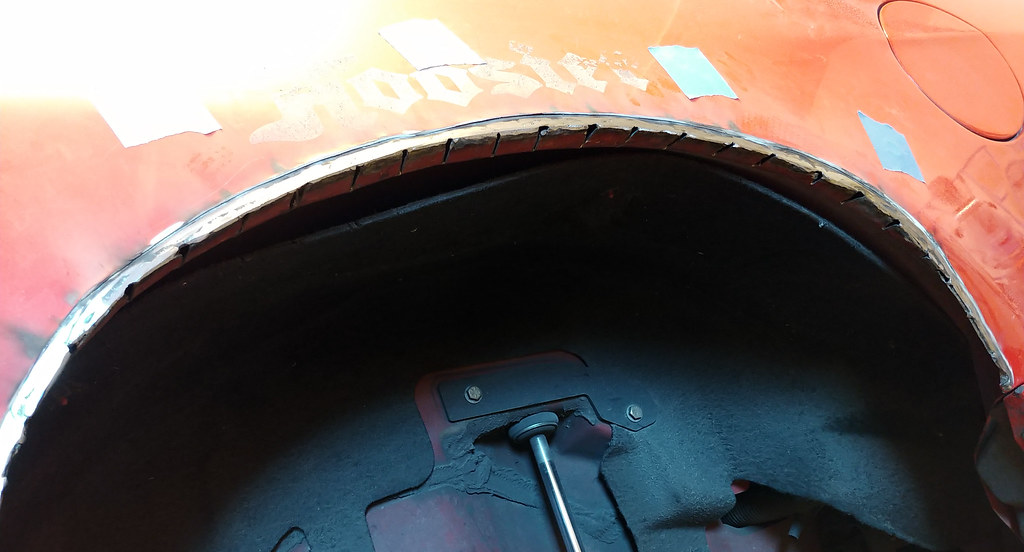

    We have fixtures for sale now to make this cut cleanly, centered, and painless. We have done this to dozens of S197 and now S550 chassis. It is necessary for additional camber travel "at the tower" and allows you to make more tire clearance at the strut-to-spindle location.
    [​IMG]

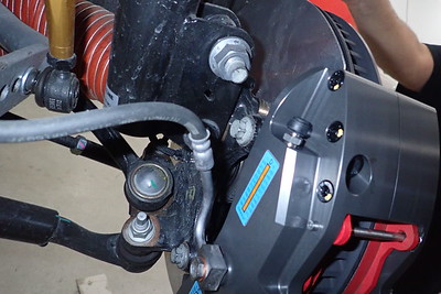

    And not knowing or seeing everyone's suspension up close, I can't say if their slotted junction is ideal or not. You have to realize how much movement there can be in the spindle to strut junction. This is an Ohlins strut on our S550, above and below. The AST and the MCS both had similar amount of slotted hole movement. There's no hard and fast rule of "all the way in" or "all the way out" that works for every situation. Its a measurement you have to creep up on, after several iterations of moveement at the spindle + camber adjustment at the top.
    [​IMG]
    With the splined bolts used on the later S197 and all S550s, its even more difficult to sneak up on this happy medium. If you push the slotted joint all inboard, you get crazy camber but the tire likely rams into the strut. If you go all the way out with this slot, you will have loads of inboard wheel room but still push the wheel outside the fender, even with max camber and cut towers. It takes a little bit of both...

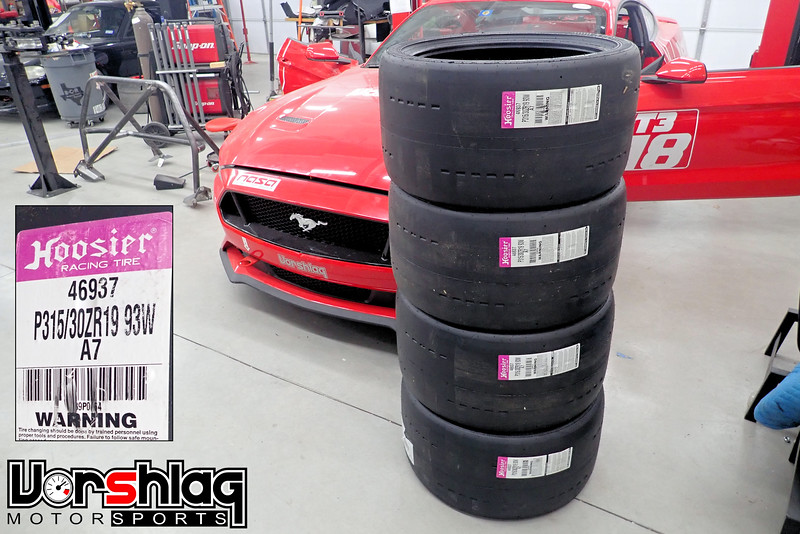

    [​IMG]
    If you can make out those published specs, the 315/30/18 has 12.5" of section width and 11.8" of tread width. They recommend an 11-12" wheel. Again, really should rethink that 10.5" Enkei. And the ability to easily rotate kinda goes out the window with anything wider than a 10" wheel on the S197, due to very differing flange-to-flange axle widths. Unless you are willing to use massive spacers on the Group Buy wheels.

    UPDATE

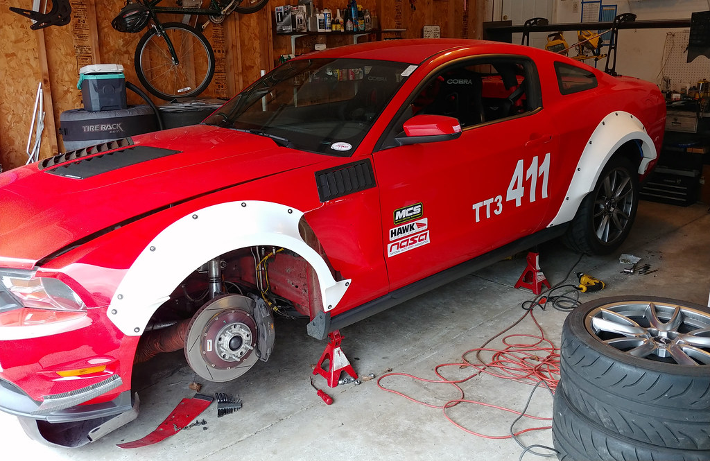

    I decided to purchase the TruFiber flares (1.5" wider in the front, 2.5" wider in the back), and I got them mounted to the car. I would say the quality is "racecar good". If I wanted "show-car good", it would take a lot of extra sanding and filler, but I don't really care to make it look perfect. I'm going to drop the car off at a body shop in a few days to get everything painted, so I'll see what their opinion is. I cut the front fenders and inner liners for clearance, which was very easy. The rears took a bit more work, as I expected (and had been warned). It took 10-12 hours to cut the quarter panels, cut and weld the inner sheet metal to the new quarter panel shape, and grind the welds smooth. There are still a lot of gaps/voids the body shop needs to fill, so I'll get their opinion about what the most cost-effective solution will be.
    I also bought some 18x12 front wheels and 18x13 rear wheels from Vorshlag (per their specs), got some 335mm R7's mounted, and test-fit them earlier today. The rears fit no problem; they're just inside of the flares and I didn't have to remove the bump-stop mounts. The fronts are a different story. They stick out a little past the front flares, and that's with ~4 deg of camber and only a couple millimeters of clearance between the tires and struts. Also, while the tires just barely clear the edges of the front bumper as you turn the steering wheel, they contact the front inner fender liners if you turn the steering wheel more than one revolution. While you normally should never have to steer more than a 1/2 revolution on a track, I imagine body roll will make this a lot worse, and the tire will eat the liner if I have to catch a big slide. @Terry - did you have this issue with your 335 setup? Any suggestions? I'd rather not eliminate the front liners both for aero reasons and because I don't want to make a mess inside the front bumper cover. I'm thinking about cutting part of the liners out and spacing them forward by ~1" with sheet metal. They seem to clear at full lock everywhere else.
    The other concern is that with the huge tires and "stance" flares, there will be a BIG loss in downforce, but that shouldn't be too hard to fix with a little sheet metal attached to the fronts of the flares. There will probably be a noticeable drag impact too, but that's pretty hard to avoid when you add ~1.5" of tire and fender width on all corners.
