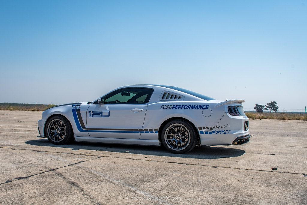

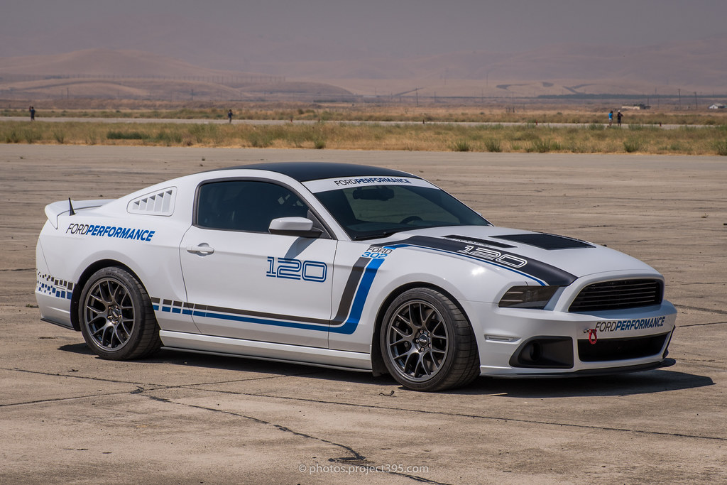

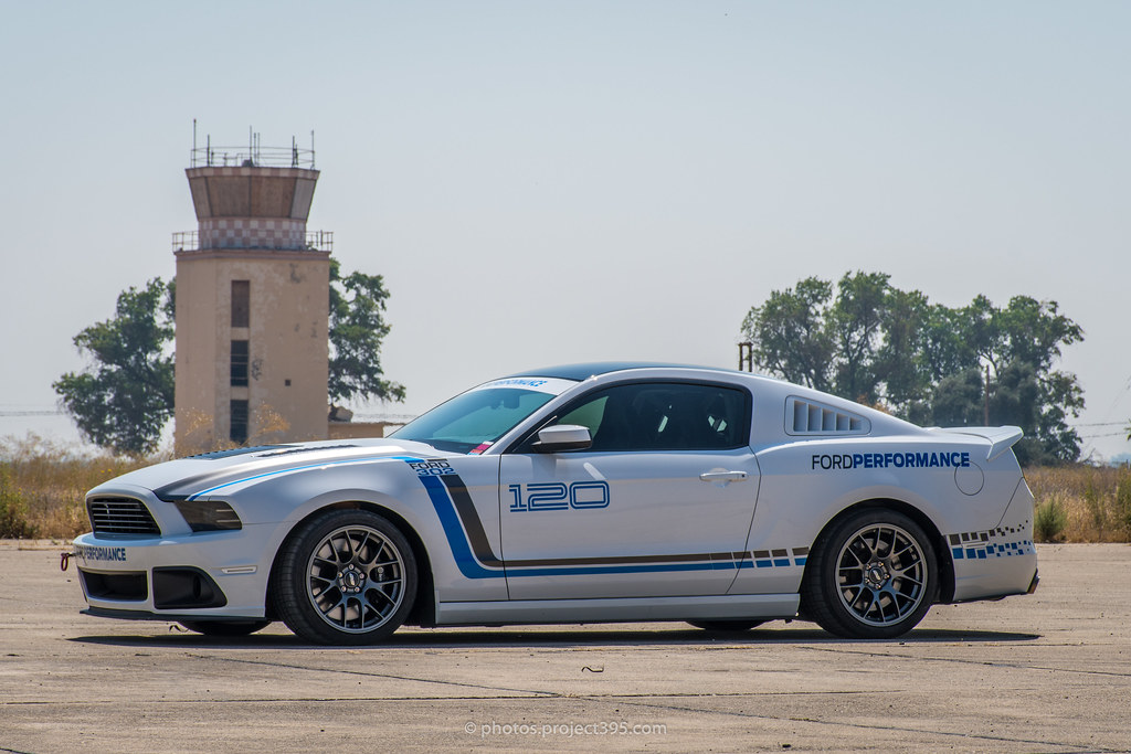

    If you want to go with 18" wheels and run a fast 200 TW tire, then 18x11" is the route to go which allows you to use the 315/30-18 BFG Rival S. This is the hot ticket for an 18" autocross setup and as an added bonus our wheels our rotatable, ensuring you get the most out of the setup. When combined with a good amount of negative camber up front there is no poke, and best of all no wait time as our wheels are in stock and ready to go. No waiting months for them to be built or being forced to buy janky, raw wheels to get them sooner.
    This car pictured is running our 18x11" ET52 wrapped in 315/30-18 Rival S with a 25mm spacer up front and Ford Racing hubs so it can be rotated.

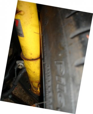

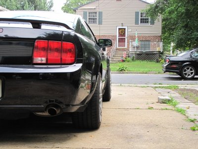

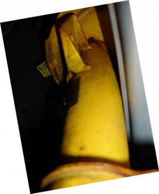

    Rear will poke somewhere around 1/4" more than this. As shown, the tire is actually 300 mm wide. A 305/30 on 11" might run 10 or 12 mm wider than that (5 or 6 per side as "bulge")
    Up front, I think a 25mm spacer will be too much to 'tuck' any more than just the tread, even with -3° camber. The 5/16" or so that you'd "gain" with -3° over what my roughly -2° gives will be more than eaten up by the difference in your effective ET being +25 and the actual offset of my front wheels. Maybe around 1/4" further out after all is said and done. On the other hand, you should have more strut-side clearance (mine's really, really tight, like under 1.5mm as shown . . . no, it didn't rub even at 1+ lateral g's).
