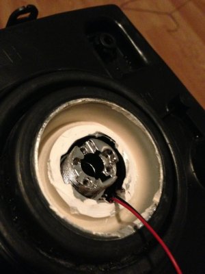

Did you take any pictures of the back of the headlights and what did you use to seal it up with?

Yep here you go. Basically I had to sand down about 3mm to get it far enough to put the bracket and bolt on. Also notice I made a small grove at the bottom to put the wire through.
Next is the wide bracket
Then just screw in the nut and it compresses everything together.

Very nice! been wanting to do this mod since i got my car.Was getting these to aim straight a PITA?

Nope I mounted it once, pushed the reflector housing where I needed it to line(since projector is mounted to reflector, I just move the reflector) made measurements how Fa the reflector is from the base of headlight, and stacked some weather strip under it and glued it tight so it won't move...... Yeh I ghetto rigged it but I'm confident it will not move, and last. Lines perfectly on the first try.
