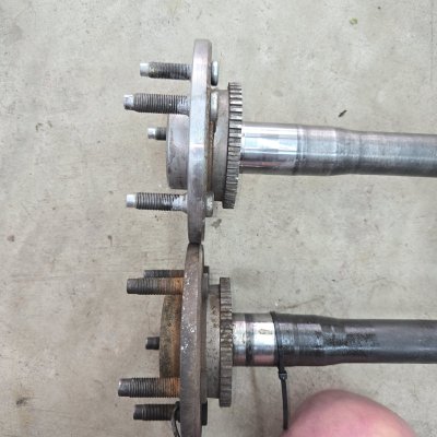

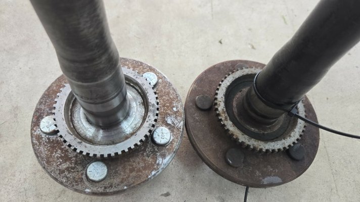

Added some pics but I know it can be hard to tell from the pics what the differences are. Axle that came out has the shiny back hub surface, new to me used axle is the dirty looking one. It came out of a 2014.
Wasn't able to get the axle until today, it looks to be in good condition. She fit like a glove, pushed her right in, c clip went on with zero issues or muscle. I cleaned up the backside of the tone ring which I should have snagged pics of to show the difference better, but the axle I pulled out the tone ring looked like it had more of a raised inner lip. I have no idea what brand of axle it is, my assumption is it is probably a dorman.
I did measure the new to me stock axle and it is the same length as the one that was in it, 31 13/16th, the only thing that seems different to my eye is the tone ring. Heck the caliper bracket even fits correct now with all kids of clearance front and back.
