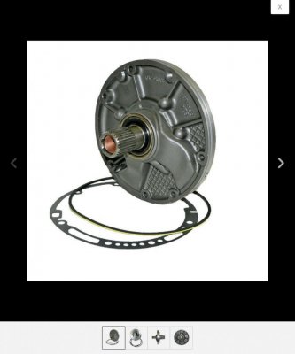

As for the brass you found, my guess is that it came from the transmission pump assembly. Did you rebuild or replace it when you rebuilt the trans?
Windvielblues197
Aug 19, 2020
11
So there was no brass missing from the pump when I took it apart and replaced the pressure valve.. and the electronic piece for the shifter is firm when tighted down but when loose it moves a little each way.. i think I'm going to go ahead and rebuild the valve body with a shift correction kit and maybe new or reman solinoid pack .. and i might even do the servo fix just cause as well..
