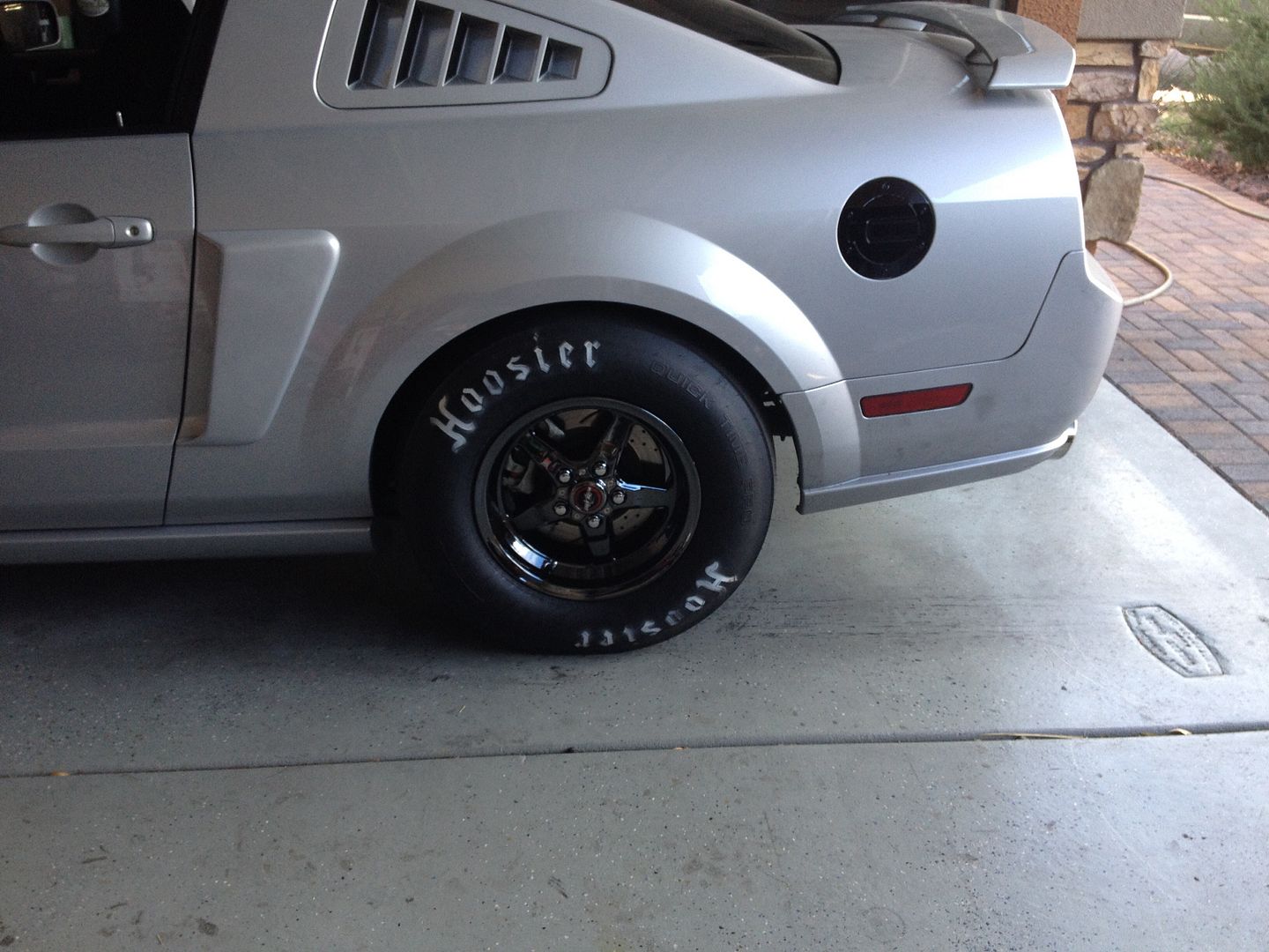

So I have pretty bad traction issues with an 800 rwhp car with 4.10 gears. Im running 19x10 Boss 302 wheels with 305 MPSS tires.
Would you guys recommend 15x10 or 17x10 drag wheels for street use? I know the 15x10 requires some modifications, is 17x10 plug n play?
I like the look of the Weld S71 Beadlocks. If I went with the 17’s, for tires I was thinking the MT ET Street R 305/45/17.

have you considered a 19" DR?
MT ET SS - P305/35R19
a more cost effective option since no new wheel is needed.
If not, 15s will give you more sidewall and ultimate traction, 17x10s will a 28" tall tire I'd suspect will work well, no alternations for the sway bar needed

Definitely 15x10. I ran Weld's and loved them.
I would also consider dropping back in gearing. Your car is way over geared with your FI and gearing with the MT82.

15’s would be the only way I would go. It will give you the most tire for the most traction.
15x11.5x28

You may need more than 35 aspect ratio. Just a thought on the cost effective side.
Pressure will depend on the tire you chose. I’d suggest starting around 20#

here's mine w' the 28" tall tire on Ford "K" springs, I think those are 1-1.25" drop
