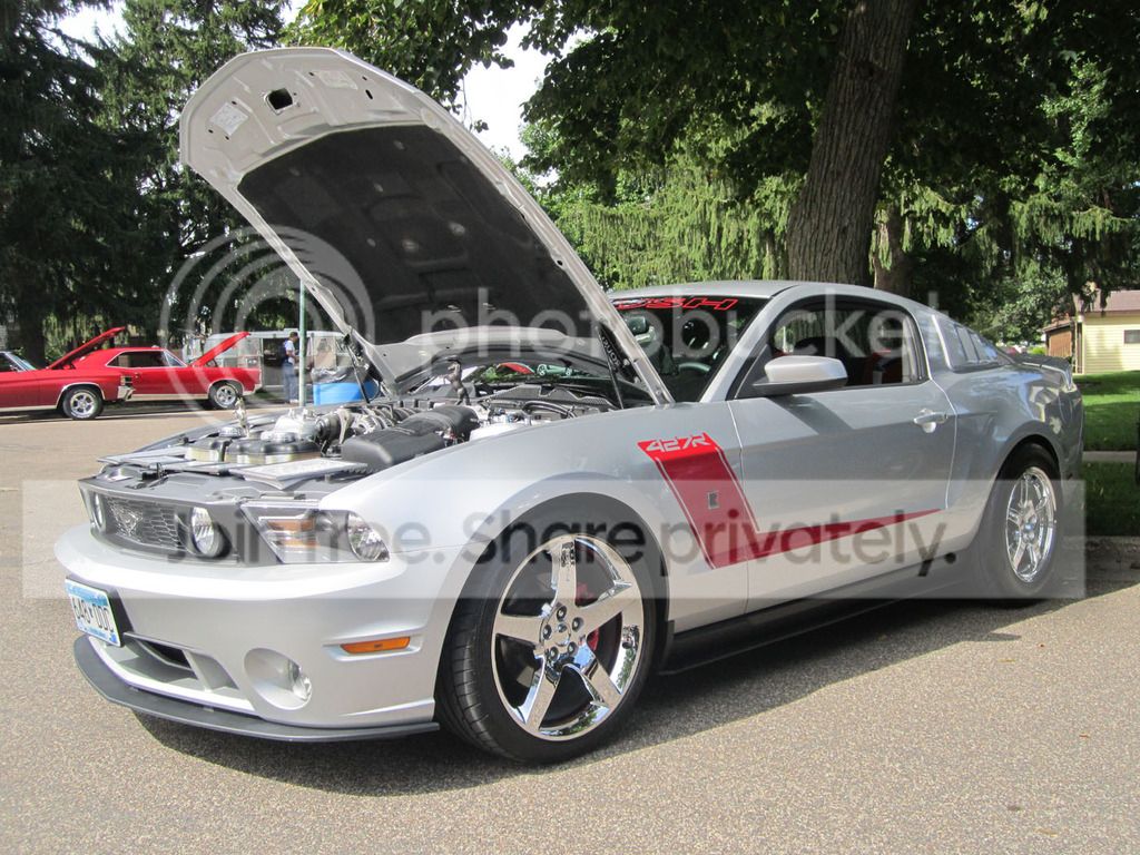

I have the Roush Sport suspension on my 2010 427r and I've been very happy with it. 50,000 miles and about 25 track days with only a front stabilizer bushing replaced. Fairly reasonable in price and I believe you can find other vendors that have it cheaper than directly thru Roush, check Summit Racing. If your not looking for a full blown race suspension IMO its a very good option. Says 1 inch drop but believe its closer to 1 1/2.
https://www.roushperformance.com/pa...ategory/mustang-suspension-kit-2005-2010.html
Tires I have 20" Roush wheels with 275/35/20 Mickey Thompson Street Comps, I've been pretty happy with them for their price and have been running those for the last few years, I'm on my 3rd or 4th set, can't remember.... I recently purchased Firestone Indy 500's same size but won't have em on until spring so can't comment on those yet.

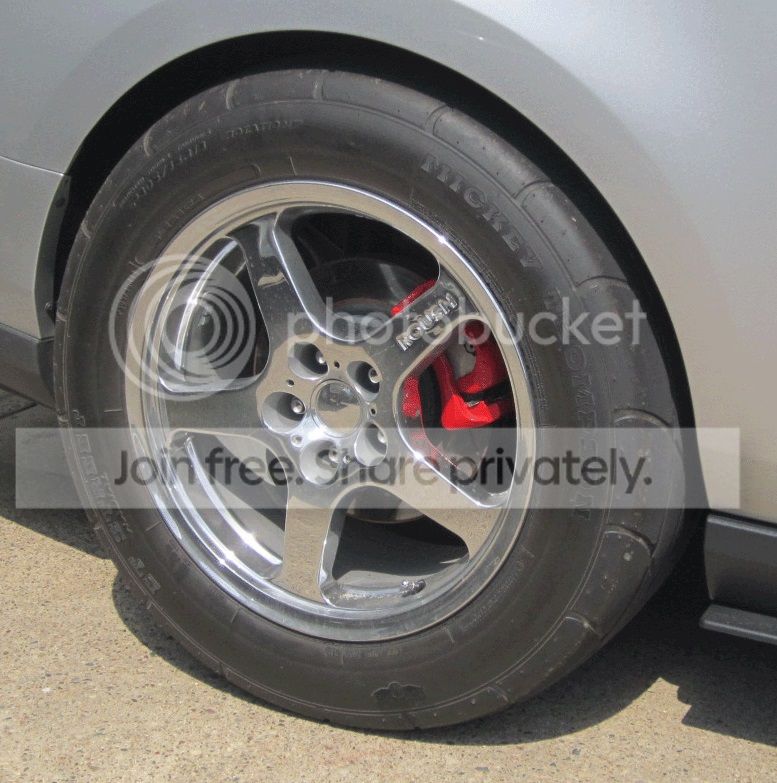

If doing 4:10 gears I'm assuming you are looking for a drag tire??? I have Mickey Thompson ET Streets 305/45/18 on 18x10 Roush wheels. They will fill your wheel well quite nicely. It is a 29" tire.
That does fill the well gap good. Is that factory height or did you drop it? Whats your front wheel/tire specs? I like those rims... do you have any full car pics?

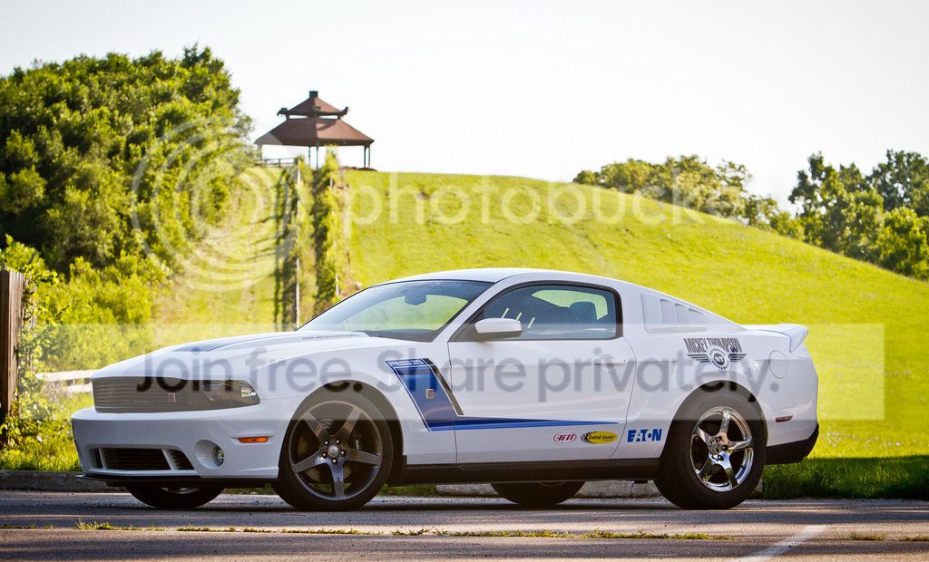

Roush Sport suspension that came on the car. My front's are my daily 20" Roush wheel with 275/35/20 MT Street Comps, was always going to get the 18's for the front but just never did. Was initially going to do a drag car but I got into track days. I still try to get on the 1/4 mile at least once a year though.... This was the similar setup that was on the 2012 Roush Track Practice Development car.
https://www.roushperformance.com/bl...g-our-new-track-practice-and-development-car/
I like it. Maybe ill keep 18" bullits on rear with big tire and order a couple 20" bullits for front. Need to think and read on it more.

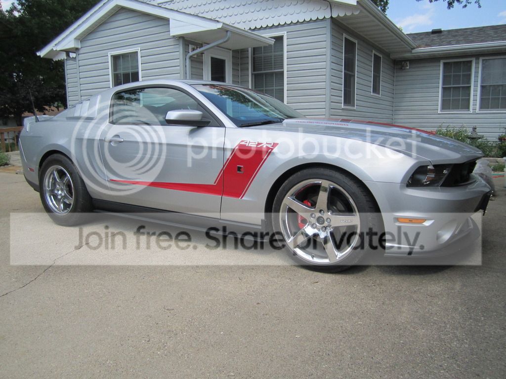

I put a better pic above, here's another pic since I'm in the sharing mood today...

I like that 18" rear 20" front setup!
