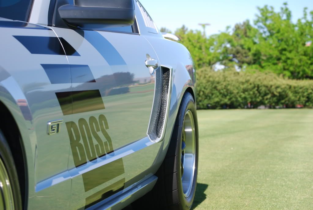

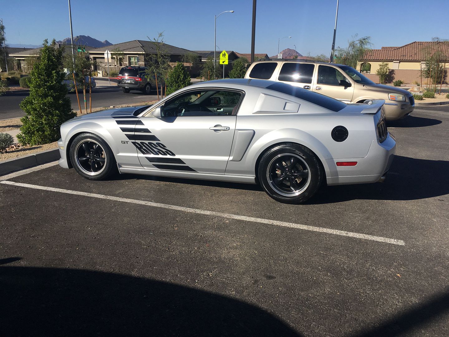

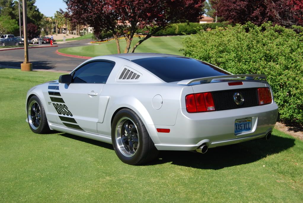

305/45/18 on a ProKit drop. I think it's the perfect fit for the wheel well. No rubbing.
Bottom pic is with CobraJet RA springs in the rear and BMR GT500 springs up front.
It did drop my effective gear ratio from 4.10 to about 3.83. I was originally going to go with 3.90 gears so it worked out to be pretty close.
