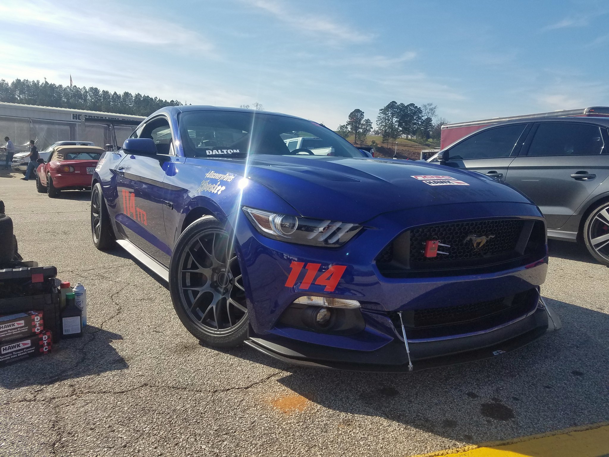

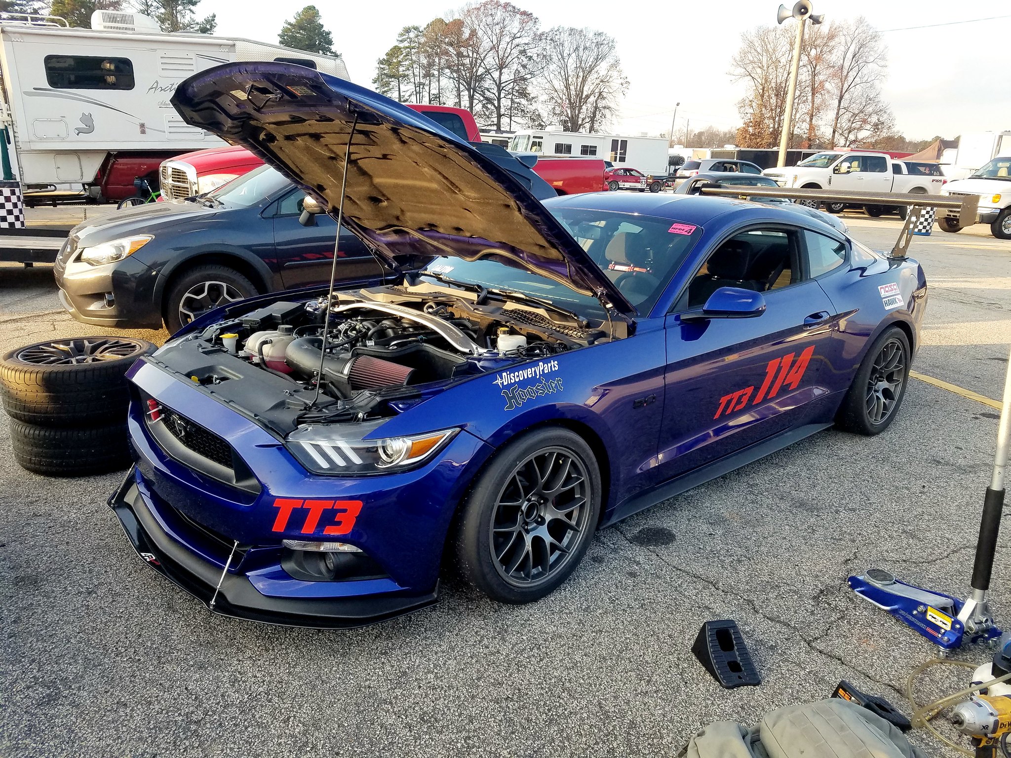

- APEX 19x11" ET52 EC-7 Wheels in Satin Black square
- 305/30/19 Nitto NT01 Tires
- 25mm Spacer upfront
- OEM Lug Nuts (GT350R comes equipped from the factory with 3.5"+ extended studs)
