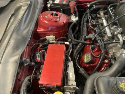

I’m also installing an MSD 2 step in my 2010 GT. I had no trouble finding the blue wire with orange stripe on the clutch switch and it does ground when activated. I am going to intersect this wire in the engine bay rather than taping into it under the dash. Just need to find it at the PCM connector.

Fairbanks, Alaska
Success with the easy 2 step install. Picked up the blue wire with a orange stripe at the PCM and taped in a few inches from the plug. Easy to mount the MSD box right next to the fuse box. Clean, no mess and wire loom reaches the engine without stress. Best of all; it works.
