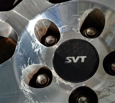

2007 GT500 stock wheels have "worm-like" etching under the clearcoat
shelbygirl
Jul 20, 2016
19
Yes, the car has 104000 miles, but I would like to know how this "worm-like" etching happens and is it time to get some new wheels?
The manual says 18" x 9.5" and 5 hole @ 114.3mm with +45mm offset.
What I don't know, is the stock backspacing and should I care?
It is more difficult to find rims with +45mm... but find many with +40mm.
Does that 5mm really matter?

That worm like etching is caused by delamination of the clear coat from the underlying aluminum. The easiest cheapest solution is to have the wheels refurbished to look like new again.

That is the start of clear coat failure. The +40 offset will push the wheels out closer to the 1/4 panel. Generally speaking a 10” wide wheel with +40 offset and a 305mm tire Will be pretty close to flush with the wheel lip if you decide to go with new wheels.

Can you sand blast them and clear coat them? One of my wheels has some crap under the clear coat. Dremel is doing absolutely nothing to clean it up.

I’m curious if anyone has had theirs refinished. I have the same wheels and mine are doing the same thing. Wonder if I should buy new ones compared to having mine refinished.

If you're happy w/ the rims, then get them refurb'd...if not, time to safe for some $pendy replacements.
