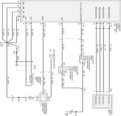

I'm researching PCM pins, and pin 10 is a ground on C175B for the PCM, that one checked out , ohm results and continuity are fine touching the chassis, however pin 47,48,49,50 are also ground for other PCM controlled stuff like MAF, i did a test on those and I have no ground there, well 2 are just blank, other 2 have a weird number, continuity test doesn't beep. Not sure if is normal or not but that seems suspicious. Any ideas ?

If you're missing ground at any of them that's not normal.... Pins 47, 48, 49, 50 should see a direct connection to ground at all times (See grounds pg 10-1 in wiring diagrams). If you cannot read a solid ground (solid beep or less than an ohm) at any one of them trace the wires from C175B to S115 (splice point) and then on to their ground point G102 (check out component locations pg 151-2 in wiring diagrams). Disconnect the ground side (G102) and do continuity checks from end to end (and then at the splice point back to pins 47-50) on each of them. If you don't get less than an ohm I would suspect physical wiring or end connections. Clean the ground and ground eyelet; reconnect and check ohms again from each pin to ground (flex the wiring while you're doing it to see if the reading changes on any of them). Look for corrosion or other issues with the wiring. If you identify any wiring that is definitely not making a connection (end to end/end to ground) you may need to remove tape/insulation to trace them and determine if any wiring is open or has failed due to corrosion or connection points.
From your description of intermittent starting; then disconnecting/reconnecting the PCM ground appears to change your symptoms so this may be the problem or at least one of them. You can also try adding a temporary ground from the PCM body to the main ground at the passenger strut tower to see if that changes/improves your symptoms.
