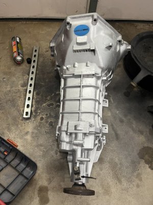

Thanks for everyone's replies. I've had issues finding the 3650 anywhere around me. I talked to a couple guys about rebuilding the one I had and they gave me astronomical prices. I finally found a used one that has been tested and ran through a dyno. I've got an MGW shifter on order and we'll install that after we get the car back.
Thanks again.

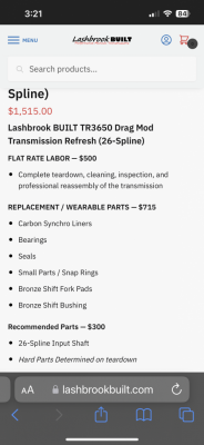

Just had this done to mine. $300 cheaper without input shaft upgrade. Had damaged reverse gears replaced & case coated…total cost $1750. Thought it was a good deal, reputable shop!
