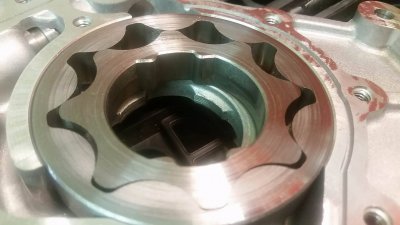

These pics are the Boundary gears after 1 heat cycle of idle time. In a brand new GT500 pump, in a perfect setup.
Seen the exact same thing with TSS pump, moral of the story is to not run debris through the pump. Can upload more photos, but this is the one I had on hand. Same symptoms, extremely low pressure after dyno run.
Feb 8, 2014
258
Brand new pump, new gears, new pickup, new pan, perfect running shortblock. Debris from where? Everything was surgically clean. The only debris was from the boundary gears eating themselves

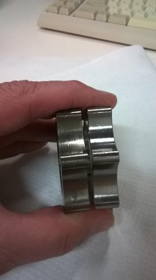

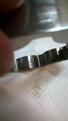

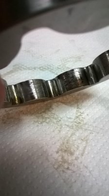

I've been running the Boundary gears for 18mo n' 10,000 miles with no issues.
Here's a pic of the Boundary gears vs the cast OE, the outer Boundary gear is showing more marks than the cast but the inner gear looks about the same as the cast GT500.
