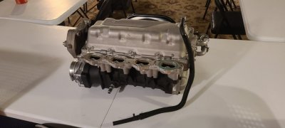

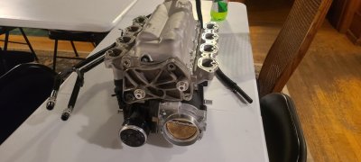

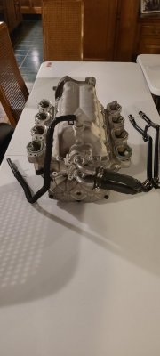

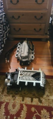

I was able to pick up a 2018 roushcharger 2650 that was lightly used including the intake manifold, throttle body and air intake housing (not pictured). I am working on building a list of the parts I need to build a whole kit and install on my 2011 5.0 Mustang GT.
I'm not looking at making a massive amount power at this point just trying to round up enough parts to make it functional. Next on my list will be a coolant reservoir, heat exchanger and coolant pump injectors and a tune.
Has anyone seen or installed one of these kits on a 2011 or Gen1 coyote? I'm still trying to figure out what what other modifications would be needed to get this up and running.
