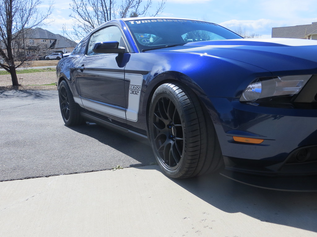

19x10.5" ET45 sits half a mm further out than 19x11" ET52 which is a proven direct fit in the rear that does not poke at all. A 19x10.5" ET51 would certainly work well, but it's not at all a bare minimum requirement.
Here is 19x11" ET52 on the back of this Boss 302 with a 305/30-19 Pilot Sport 4S

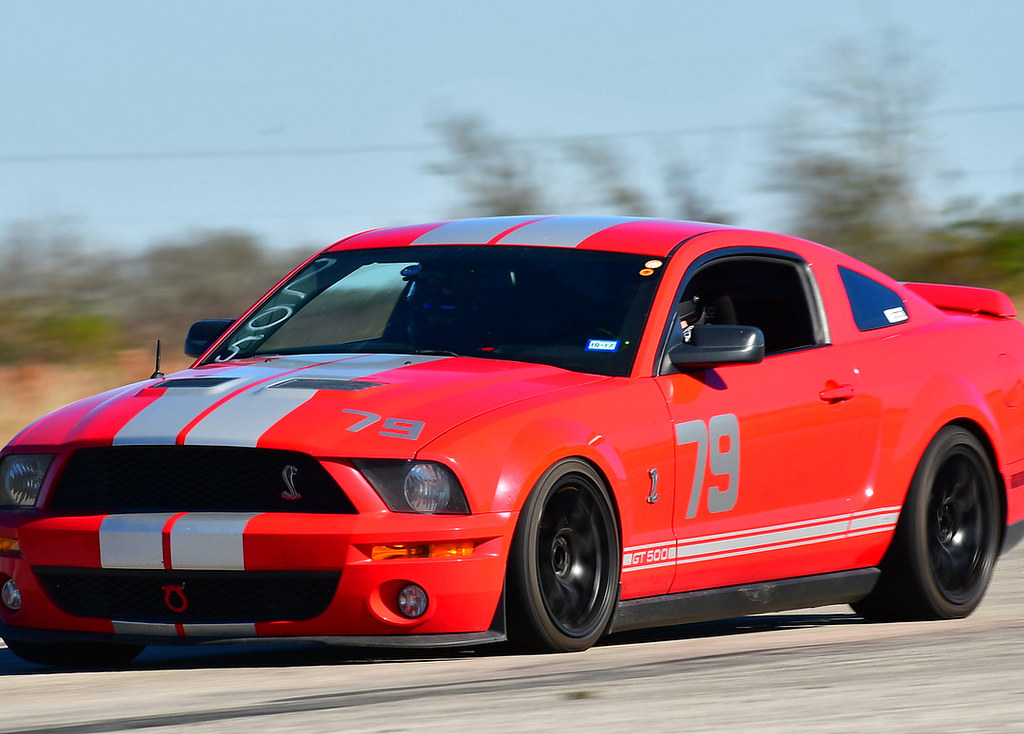

Finally, here is a GT500 with 18x11" ET52 wrapped in a 315/30-18 BFG Rival. Not the best angle, but you get the idea :)
