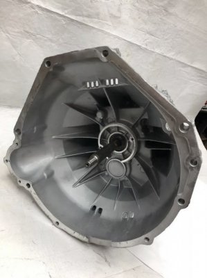

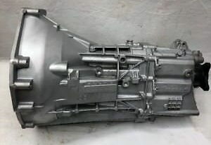

The MT-82 transmission bell is integral to the case. In fact, it is part of the case and not removable.
This is a V6 MT-82

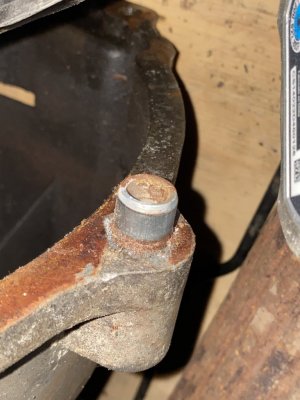

It can be frustrating for sure. So... the cowl drains like I said, water can leak into the trans/engine plate and the dowels. And you get corrosion. The last one I couldn’t get to break free. I thought I missed bolts as well. Ended up pulling engine and trans together. Smacked the dowel areas with a hammer and still, two pry bars. Good luck.095A5B4F-5D26-46DB-AAB6-305148AAD9DE.jpeg8B356747-63AC-4CAB-AB8D-0CA04BD1C72A.jpeg C48F7090-1618-423F-92B3-71B0A145A640.jpeg
